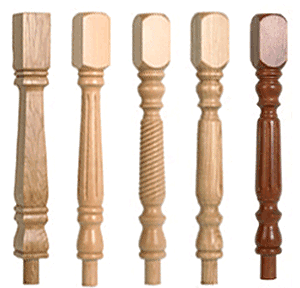

a new newel post because the current one looks a bit rubbish
See the bottom part of the newel post which is square/straight before it becomes "rounded" ? (hope the pics work)
Well saw it off a few inches above the floor/stair string ....cut it straight !
Then buy a newel post like this :
And bore a hole in the centre of your "stump" the exact diameter of the large dowel at the bottom of your new newel post. Glue the new post in using plenty of PVA glue. Your new handrail will also help to keep it sturdy.
