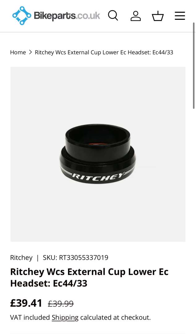

I am going to replace the fork on my steel Genesis Equilibrium with a through-axle fork. The head tube diameter is upper 34mm and lower 44mm.
Looking at what forks are available on eBay, there seem to be a lot of 1 1/8 - 1 1/4 tapered steerer forks, but suitable headsets with 1 1/4 lowers seem more difficult to find. (e.g. Hope don't do them in that size at all)
Any ideas of who makes a suitable headset?

EC44/33 lower headset will fit. I’ve not figured out how to post a link yet, so here’s a photo instead:
IMG_6913.jpeg Those Ritchey forks are lovely!
