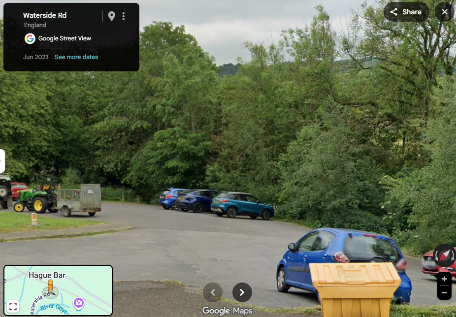

I bet she's parked kinda where the Tesla is in this photo (it's steeper than it looks on this photo too)
