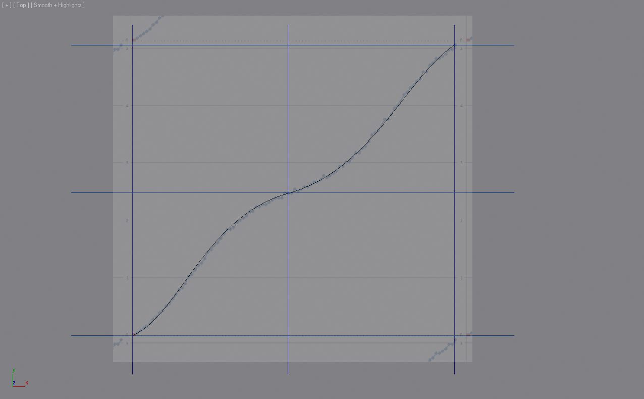

trying to find the ease in out function that matches this curve.
it's none of the usual suspects (smooth step or cubic (or any other simple polynomials), I can split it into to 2
bezier solutions but was wondering if there was anything else ?

looks like 2 curves to me? be interesting to know the maths behind making it.

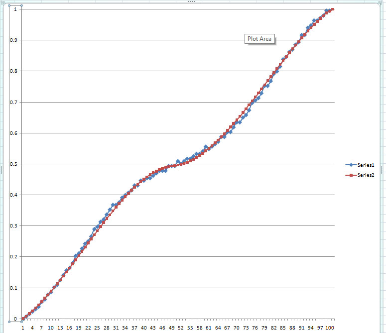

anyone interested the raw data is here it's quite noisey as it was converted from a bitmap

got a result that will do, a 2 bezier solution but the maths isn't pretty 🙂
series 2 is what my function generates and a graphical illustration...
the top is the original, and the bottom my "reverse engineered" variant
Posted : 11/03/2022 11:15 pm
found the exact maths in the end turns out it's 2 "scaled" smoothstep functions back to back.
the solution i'm going with is....
where t >= 0 and t <= 1
fn hermite t a b = (3 * pow t a - 2 * pow t b) -- variation on smoothstep
fn ease_in_out t =
if t <= 0.5 then
0.5 * hermite (t * 2) 1.5 2.15
else
1 - 0.5 * hermite ((1 - t) * 2) 1.5 2.15
