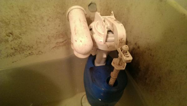

So, a couple of years ago I replaced my Victorian Armitage Shanks with a new-fangled piece of cheap crap.
Seems the inlet valve now isn't shutting off. In the old ballcock days it'd be a case of pulling a split pin and replacing a thrust valve and a rubber washer before my doubleentendreometer exploded.
With this thing though, I haven't a clue. The blue float, well, floats up with the water level but the attached lever doesn't shut off the supply and it carries on filling until it starts running out of the overflow. Presumably there's a washer inside but I can't fathom how to open it up without risking destroying the gossamer-thin plastic in the process. I don't have to replace the entire thing, surely?
Apologies for the grot BTW, next time I'll steam-clean my crapper before posting a picture.

I'm not going to be much help here but if that were my bog i'd make sure I knew where to turn off the water then get a bit experimental on it. Worst case you end up with a broken inlet valve, (which is effectively what you already have) Best case you fix it, feel smug, save on a replacement/plumber and the Mrs thinks you are a god.
If you manually lift the lever does that stop the flow?
Posted : 06/08/2014 9:09 pm

There's an isolation valve on the inlet, that's not a problem. But I'm not going to kybosh it at 10pm.
Manually frobbing the lever makes no difference, no.

Take out the entire flush valve pictured and take it into a branch of PTS. They should be able to match it up for you.
Shouldn't cost more than £15
Seriously?
No wonder our landfills are overflowing (like my toilet) and I'm broke. For a 15p washer that's shit.
I think what I might do, then, is replace the thing next week, ideally with something serviceable, and then strip it down without concern for demolishing it.

Posts: 1310
Looks like the top should twist round then lift off. The washer will be in there. Doesn't look like one I recognise. Most plumbers merchants should have a decent selection of diaphragm washers on the shelf.
What Northernmatt said--that is the way you flush debris out with my similar valve.
You shut off the water source, unscrew the top and remove it. Place a cup or glass over the open vertical pipe and turn the water source on for a few seconds (the cup will keep you from washing the ceiling in the process). That cleared mine up in one try. What could possibly go wrong 😆
I thought the same; the clips look to me like they should either screw 45' or be levered open with a blade. Trying to turn it didn't yield anything and I was loathe to force it further in case I destroyed it in the process.
If that's the consensus, I'll have another go when the shops are open. Ta.

From experience the new flush valves that the picture would seem to indicate are not serviceable and are designed to be replaced not repaired.
I know it's a crap idea but it makes more money for the manufacturer.
Assuming that to be the case, can I replace it with a serviceable one so that I don't have the same problem again in 10 months' time?

They seem to keep improving on those kind of plumbing products, so bet you can find one that will be more hassle free. As some mentioned above, at least the valve assembly isn't too pricey. I replaced one a couple months ago with a much improved assembly and here in the USA it was about $17 as I recall----and really easy to install.

If you do have a go at removing the top bit, try pushing down slightly before turning/twisting. I have a memory of that being the technique for removal on something very similar.

I've had a quick look again this morning before work, and it certainly looks like it [i]should[/i] twist. There's definitely no 'push' movement in it though.

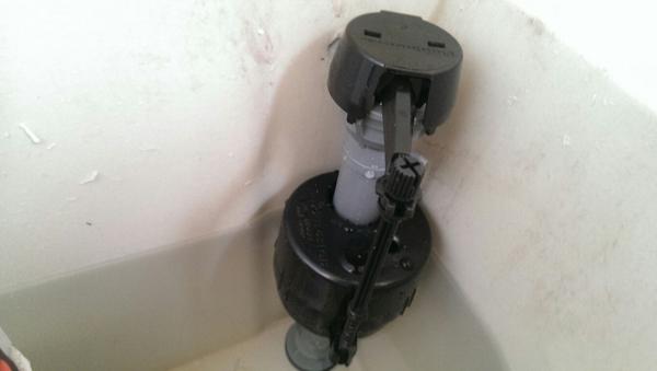

Posts: 77697
Job jobbed.
Cheers all. Turned out, the old one did unscrew, but required more brute force than I was willing to provide without a spare on hand. Couldn't see anything wrong with it when I did get it in bits. For the sake of eight quid from Screwfix it wasn't worth messing about with.

Posts: 23122
wait a minute - surely thats a picture of a different toilet to the one in the OP. I'm beginning to suspect you've solved the problem by simply moving house.

Posts: 13594
Suspiciously clean.....
I think he's just taken a stick photo and used that.......

Posts: 77697
Actual 'lol' there, thanks for that.
I did, of course, give the thing a superficial wipe down before I started on the job. Good rule for life really, that.
