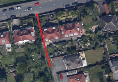

We access the rear of our property by a private road. "Our" end of the road has seen better days and I going to try and get it repaired/resurfaced, but I'll be trying to get the immediate neighbours to contribute as we all use it. I have no idea of what something like this will cost, anyone got any experience of this? We know who owns the road, but I suspect they won't want to know if we approached them about repairing it as they don't use it.
Here's the bit of the road in question, I would guess at 40 metres long and just wide enough for a car. Quite steep in parts and pretty badly worn away. I'm guessing the cost will be somewhere between "sh*t!" and "what the actual ****!" 🙂
The red line shown below:
[img] http://bit.ly/2jcblLE [/img]

It's currently not surfaced at all really - I can't tell if it has ever been tarmacced; the top part of the road is (top being the bottom of the picture confusingly!), but then it just kind of stops where the red line begins and we've got nothing more than a dirt track pretty much. I think it would need properly surfacing, as it stands it is being washed/dragged away down the hill by cars/weather. The worst culprit is the chap who lives in the house where the line starts, he goes down (and even up) it in a heavy 4WD pickup every day.

That sounds promising, I'm just concerned it is quite steep and it runs straight out in to the main road so any material that's washed away ends up on the highway. It's not heavily used, but it is used every day by at least 1 car.
Looks like I need to get someone to take a look!
