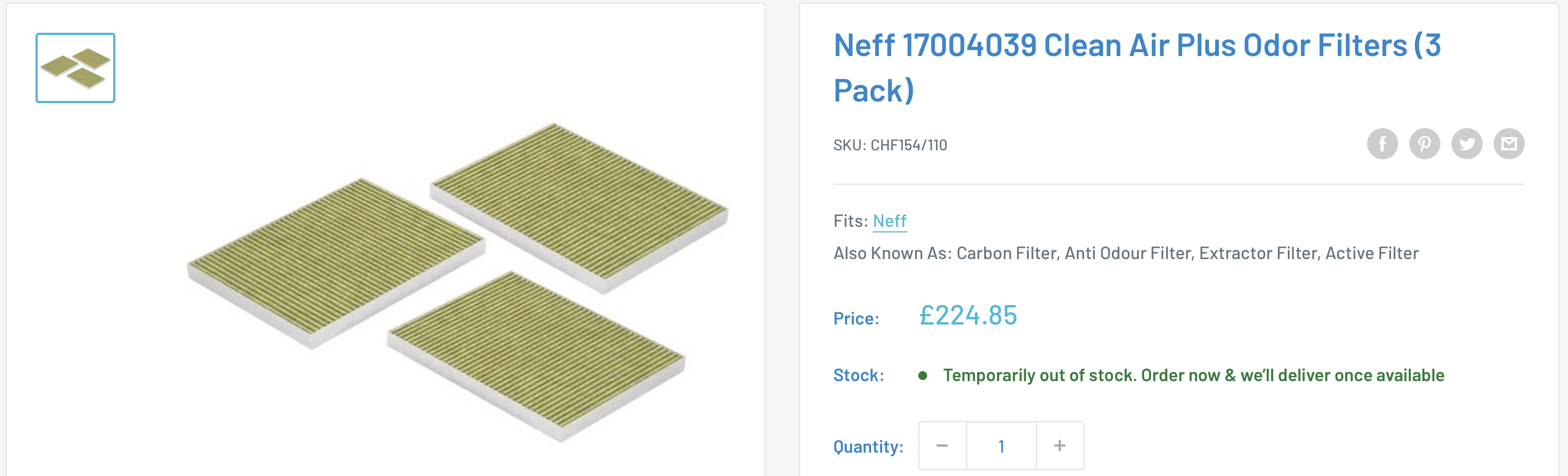

Or maybe something like this...

Most of the metal mesh ones are about £17 each, except mine which are £50. Its just slightly differet shape, its nothing special...!

When it tells me based on usage. I can't actually remember how long that is as I switched to the ones that last about 10 years that you can regenerate by blasting them in the oven - a snip at £485 (think the RRP was around a grand 🤣).
