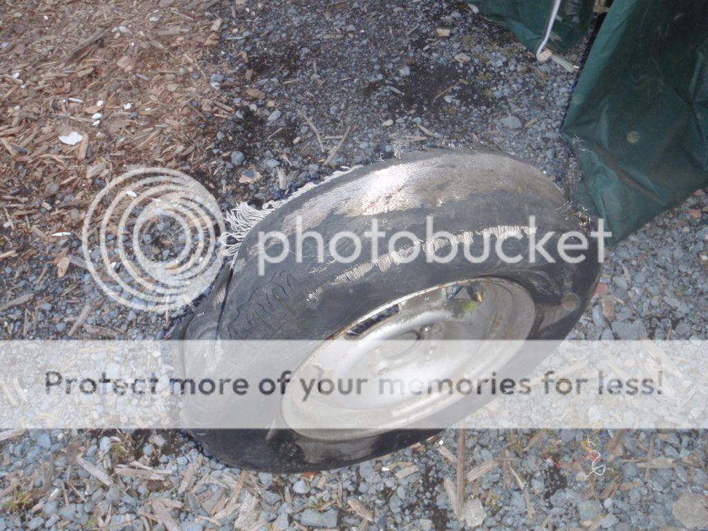

regardless of which caravan you buy, the first thing you should do is go and buy 3 brand new branded tyres. and make sure you have a jack and a wheel brace. and always check the tyre pressures before you leave.
this is what happens if you don't
my brother and i were driving to pembrey for a race meeting, and this happened on the m4 near cardiff somewhere. frightening! we had to change it on the hard shoulder. luckily we had all our tools with us, but we didnt have a trolley jack, and the van jack didnt go high enough. we had to let the air out of the new wheel/tyre to get it on, and pump it up again, all the time lorries whizzing past only a few feet away.
the failed tyre was only about 4 years old, and was properly load rated etc. it might have failed because of low pressures, who knows. we got 3 brand tyres before the next meeting!
