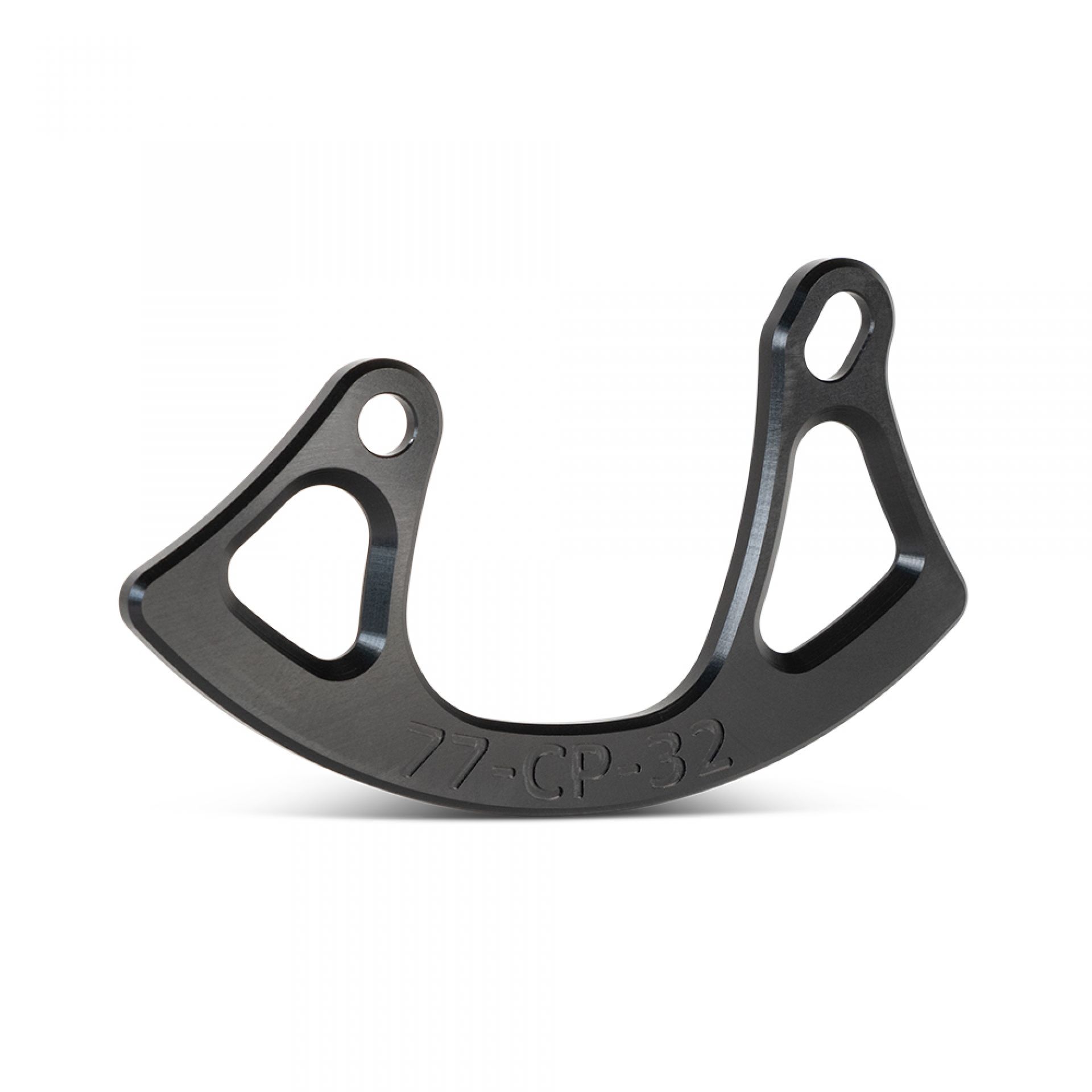

Posts: 1410
Lovely bit of kit from 77 Designs:
https://77-store.com/CRASH-PLATE-ISCG-05-V2/CP-05-V2
Bash
