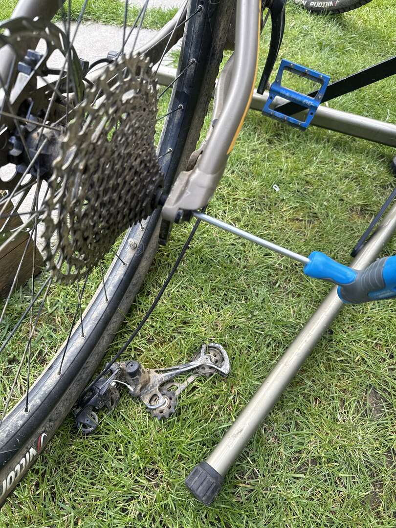

Thanks all, latest is this- after tightening the quick release end fell apart, now I can’t undo it at all.
Shite
edit- used a torx bit hammered in to turn, so I could still just saw it, the axle is knackered anyway I’ll just lose the end cap or wheel as well if I can’t then remove axle.

Posts: 5078
So I’m able to unwind the axle with the torx driver, I can have a go at sawing the hub end cap and axle. I’m guessing an angle grinder will be best here to saw through.

Luckily, I can still unwind it using a torx jobbie rammed in the threaded end as it is hollow. If I can get the quick release end bit cut off I might be able to wangle it out after cutting the axle tight to the cassette end.
Christ knows how I’ll get the axle out of the wheel though but I’ll worry about this later.

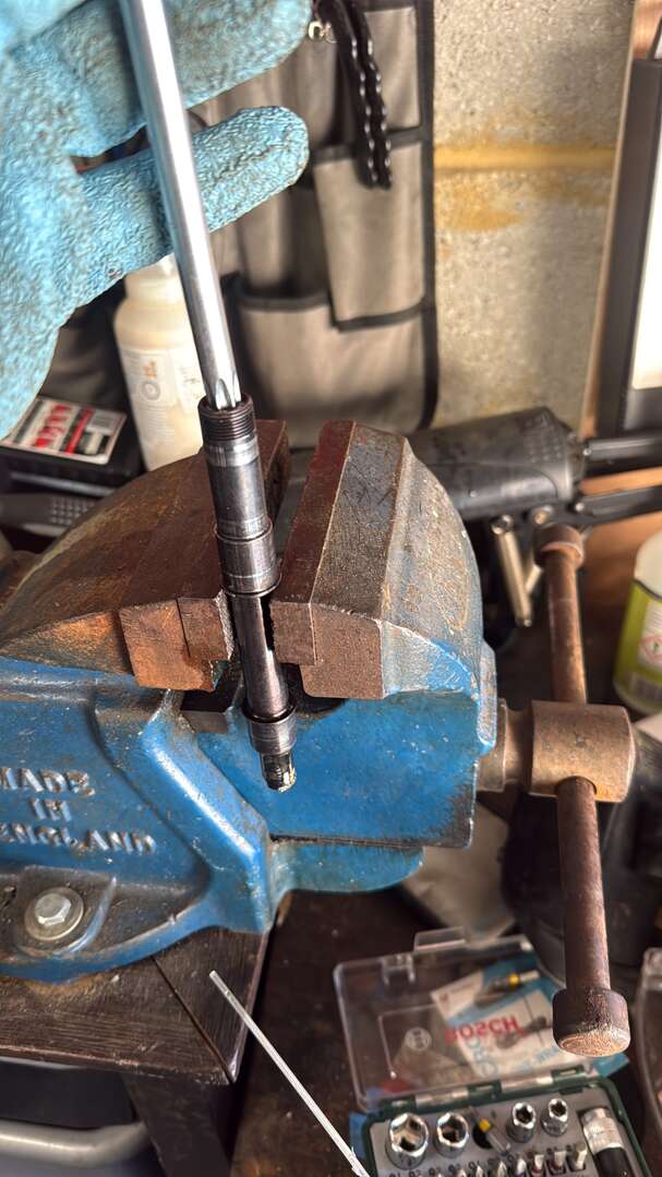

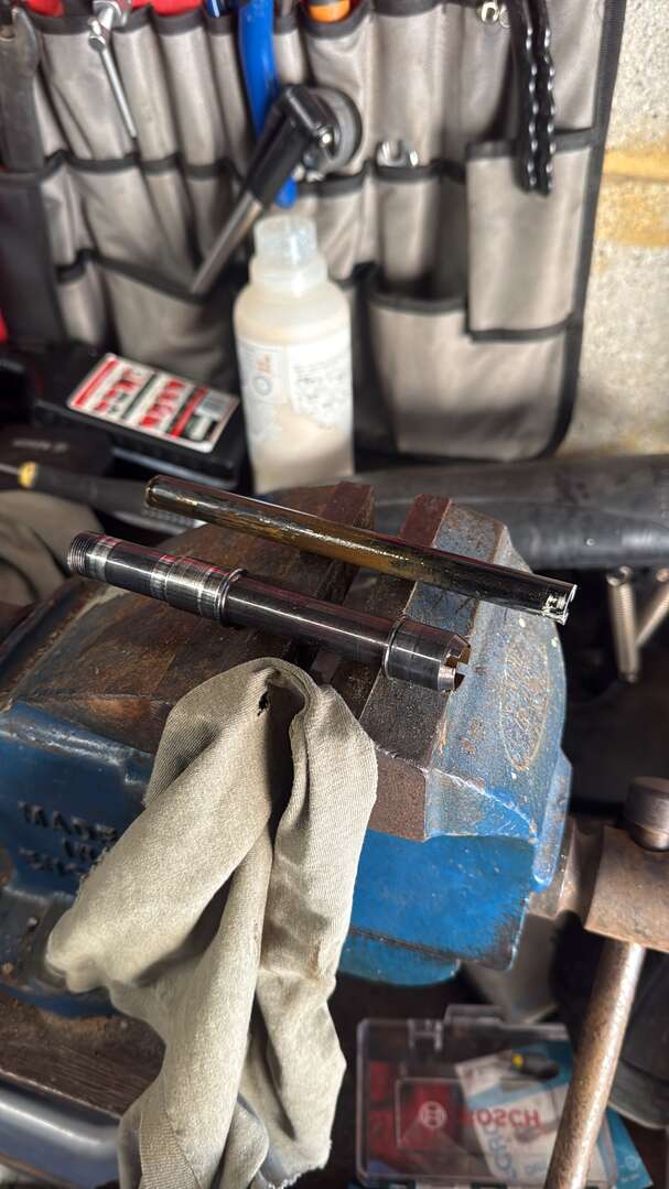

Update- got the axle out without destroying the end caps.
managed to saw right up against the caps- they are a bit scratched but not bad.
Got the wheel out and put in big vice to hammer the axle back and forth.
The inner hub bit came out leaving just that and the axle.
Put the hub tube back in vice, resting up against the vice jaws so without pressure then tapped the axle out using a big torx wrench as a punch.
