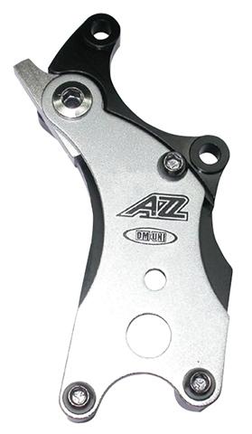

Posted : 04/08/2015 6:56 pm
hmmm not seen those adapters before - must be for steel and alu frames only though? and mtb, as thin chain stays on the road bike would not take that strain?
certainly gives a great option for older bikes ......
there are less and less excuses not to start a mtb or road or both vintage project now....
Posted : 05/08/2015 8:42 am
Posts: 41788
I'm confident the stays would be OK for normal use, you could even do it properly and get Mercian or Argos to braze a mount on, but you't never find a fork with a 1" steerer for disc brakes on a road bike, so the points fairly moot.
Posted : 05/08/2015 9:57 am
