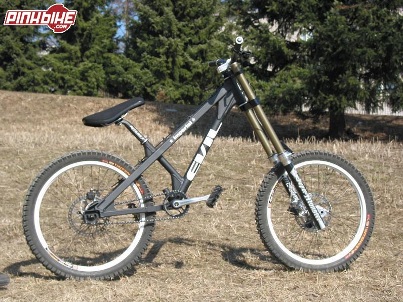

Its a times like this, the Evil is called for:
Posted : 16/04/2012 9:41 pm
