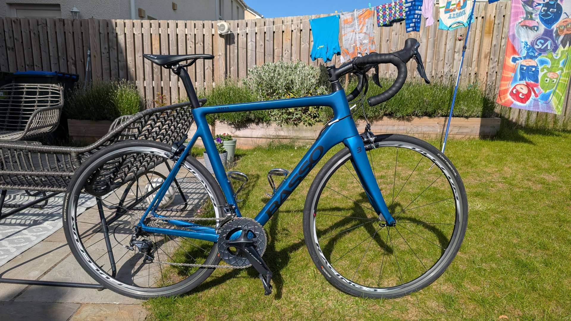

Posts: 11610
I have a Token on my Basso (pic just because I cleaned it today 😎).
It has been fine. I can persuade the bike to creak occasionally but I have never proven to myself it's actually the BB, I think this time around it was actually the rear QR.
Just be aware that the supplied tool that comes with the Token BBs is almost designed to strip, I think it's made of plastic!
