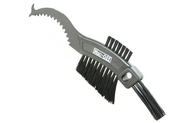

That's more like a branch! That's why I periodically use a flat screwdriver to clean the spaces between the first 3 sprockets.
Posted : 18/07/2018 9:16 pm
