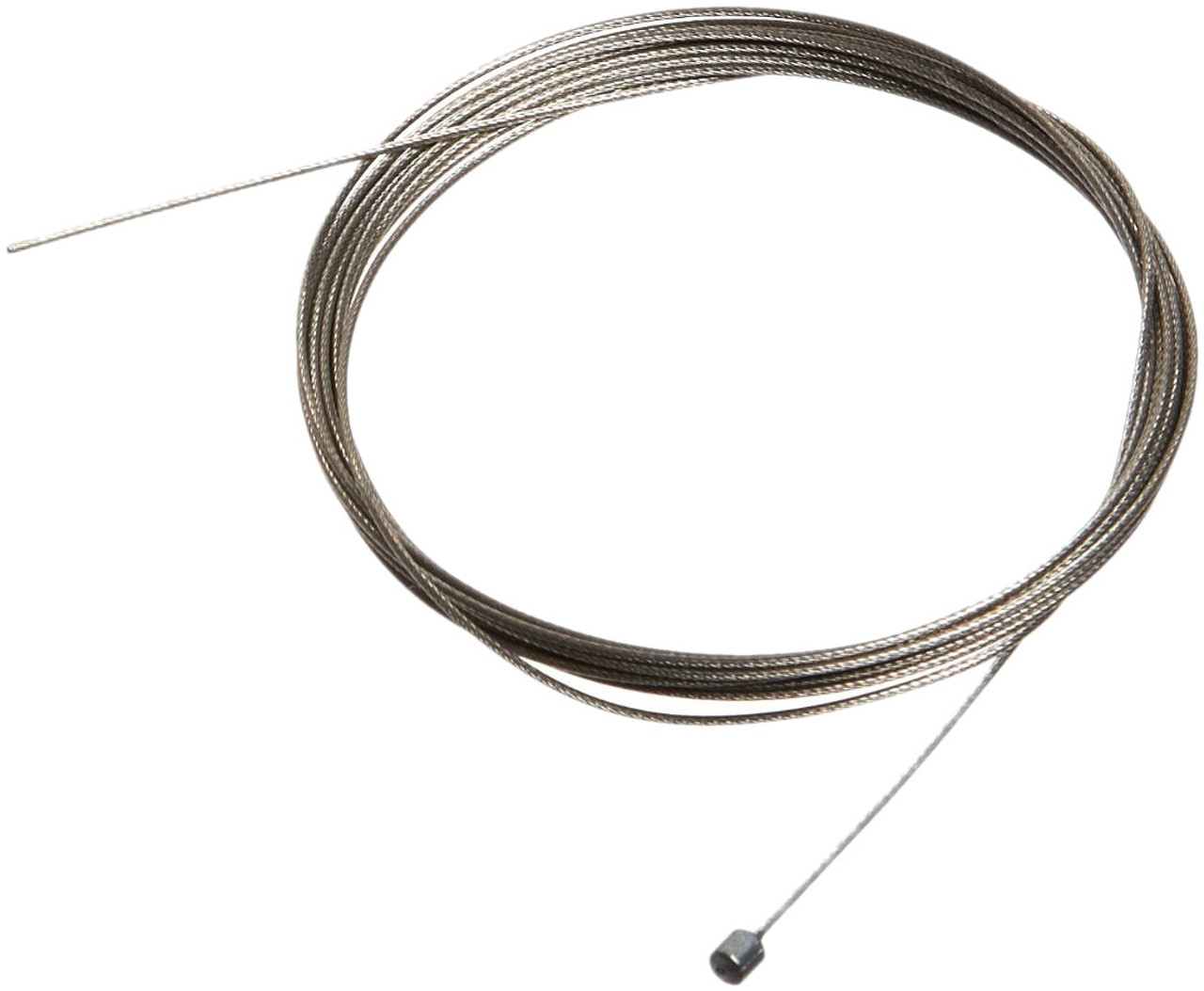

Posts: 8860
Posted : 01/05/2025 4:42 pm

Posts: 2205
Posted by: sharkattack
this
Posted : 01/05/2025 4:57 pm

And a cable is no use as it won't plug into mech or phone...
