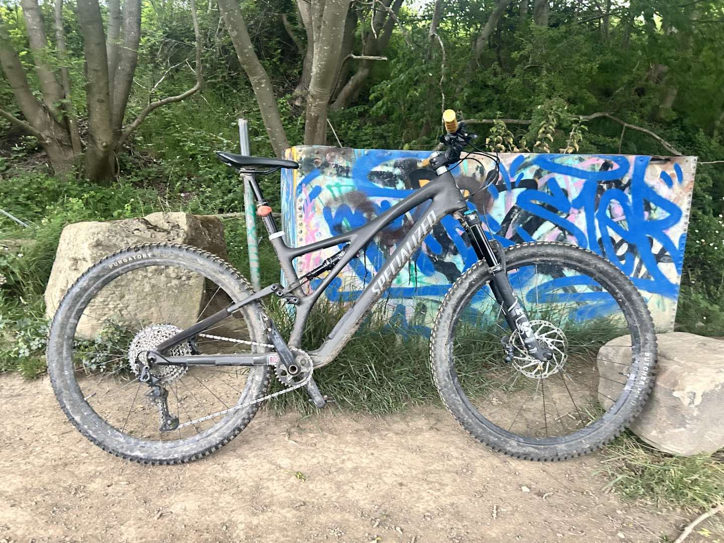

As we're posting pics:
There's nothing there that needs upgrading IMO. Compared to the 2010's we're enjoying a golden age of affordable bikes / kit that actually works!  It's all Deore and basic level suspension, WTB wheels, etc.
On paper it's 140/150mm travel but as I said the overly progressive nature of air springs + me being heavy makes that more like 120/130.  If I can solve the fork progression I'll fit a larger air can to match it, otherwise I can live with it. Maybe I'll check out the MRP forks Northwind suggested.
Will I fit XT, carbon rims, DT hubs, hope brakes, etc. Yep if stuff wears out or breaks, but nothing screams out as being below par and needs replacing for the sake of it.

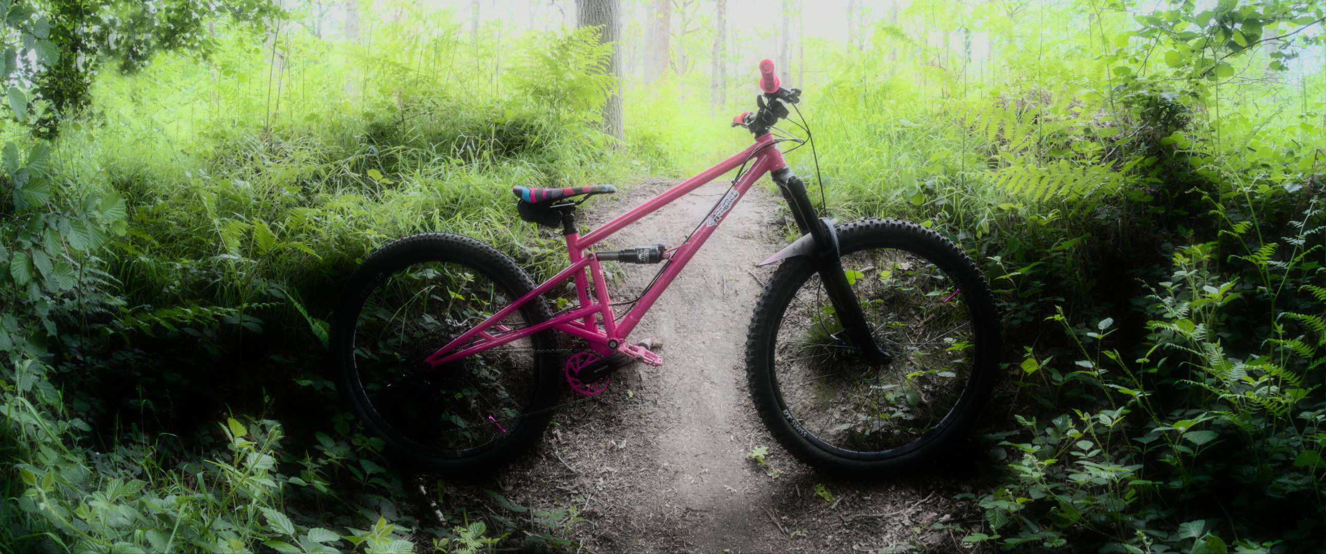

Posts: 7889
My 'big' bike and my 'trail' bike have very similar builds - just the frame rear travel is different (big bike is 160mm and trail bike is 120mm). I'm not fussed about weight too much and means I can easily swap bits around in an emergency.
160mm Lyriks with a Splug.
DT Swiss M1900 wheels. My tiny concession to weight is running WTB Vigilante/Ranger 2.8s instead of the Maxxis DHF 3.0 and Rekon 2.8 on the big bike.
Drivetrain is Microshift Advent 9 speed on a 165mm SRAM SX DUB chainset with a Works 32T oval and RaceFace Chester composite pedals.
Brakes are Magura Trail Sport with proper Magura discs. Ridiculous VFM.
Saddle is a DMR OiOi held up by a bargain Bontrager Line 170mm dropper.
'Cockpit' is as right old jumble - 35mm DMR Defy stem, 780mm BBB Ascension bars and Deathgrips.
Posted : 16/07/2025 4:12 pm
Posts: 344
More great builds and ideas, thanks.  Nothing wrong with my Rhythm, but I’ve got a hardtail it can go on and do fancy something with a bit more travel and strength up front - the Mezzer sounds interesting.
My bike as it stands now, only changed the contact points from stock. I’ll look IMG_4796.jpeg into some of the other recommendations, bonus points if things come in silver.

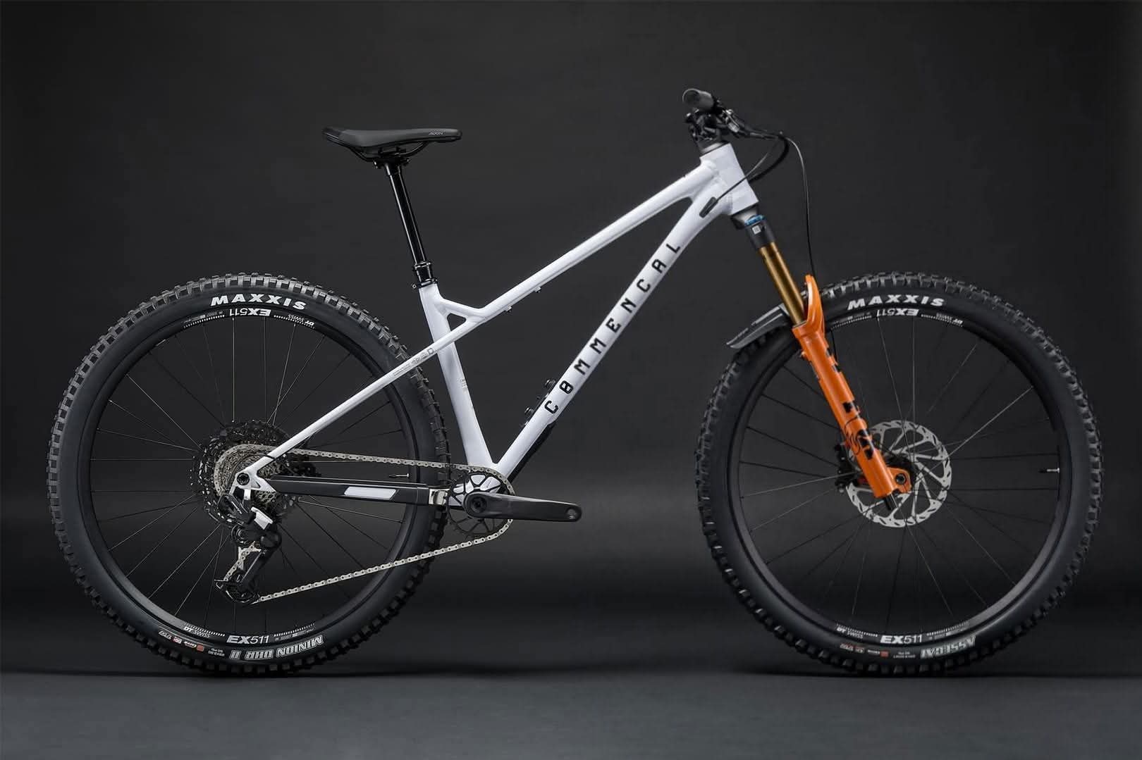

Posts: 14291
I'll just leave this here. Commencal are making some damn fine looking bikes at the moment.
New Meta HT £3k
Posted : 17/07/2025 5:05 am

Posts: 2134
£3k for an aluminium HT. I am out of touch with prices.
Posted : 17/07/2025 7:15 am
a11y reacted
Posts: 344
Also, unless things have changed, it’s 3k for a brand that has poor warranty and a reputation* (again) for cracking frames….
*source - Pinkbike comments 😂
Posted : 17/07/2025 7:47 am
a11y reacted
Posts: 14291
Posted by: nickfrog
My Big Al CRC build wasn't much shy of £2k and that was with a set of cheap Lyriks. I know yours cost a bit less, but...
Posted : 17/07/2025 8:00 am
