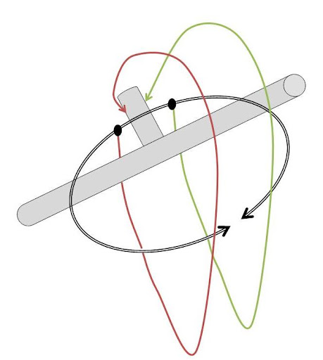

I've made a sling thingie which works well. Hard to explain, but I'll try.
It's basically a webbing "belt" which fastens round the dry bag load (bag is held vertically against the bars), then sewn onto the "belt" at right angles (dangling towards the ground) are two straps . These straps wrap around the bars (either side of the stem) under the bag and over the top to fasten under the stem with a cam.
By going under the stem the whole thing tightens up and sort of cantilevers the bag off the handlebars.
Seems to do the job with minimal bobbing/swaying as you can crank it down nice and tight. 😀

Better than a photo, it's like this:
The arrows are where the buckles would go. The red and green straps get fed through the loop on the base of the bag and through the drybag closure at the top.
