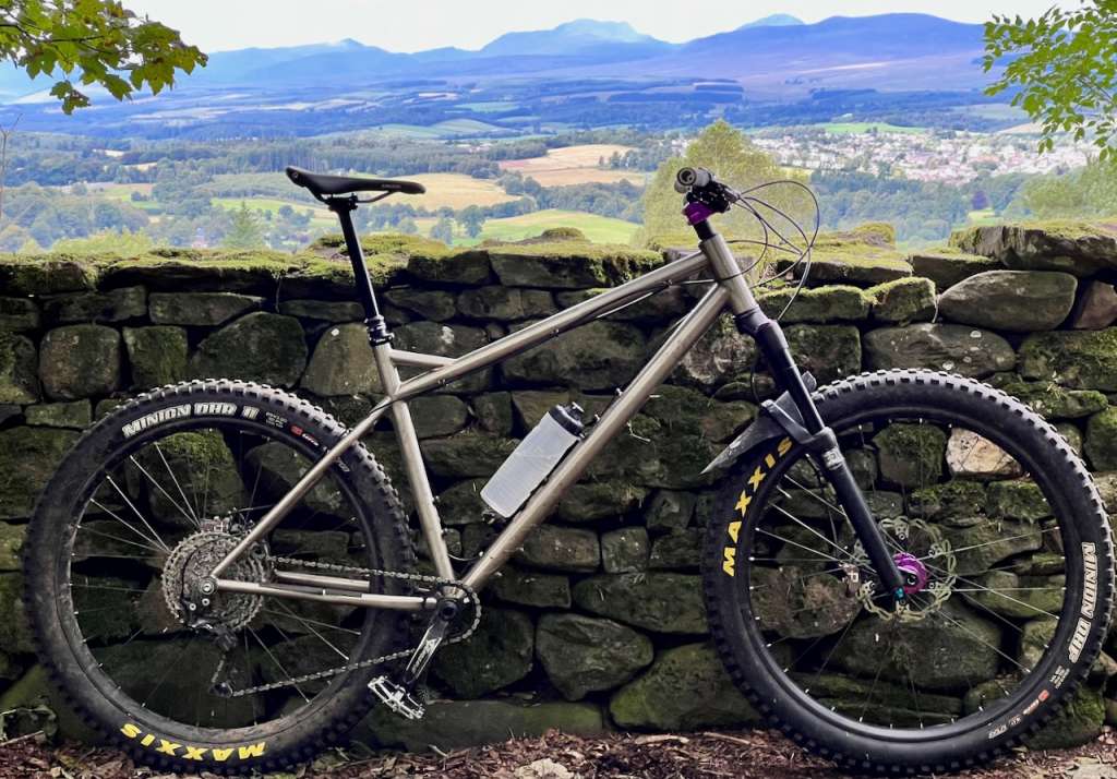

Maiden voyage on the new custom Waltly, went ok, fairly pleased with it...😀
Weather was ok as well!
The fork is currently at 140, the frame is designed for 140-160 so I'll increase this at some point to see how it feels but 140mm felt great.
Full spec is:
Waltly ti frame
Cane Creek Helm 2 Coil forks
Hope wheels/BB/HS/seatclamp
Hutchinson Griffus/Wrym tires
GX AXS groupset and dropper (no cable routing on frame, external hose routing only so I'm fully committed to wireless now)
SQ Lab bar/stem/saddle/pedals/grips
(Yes, I like things to match!)
No idea how because there's nothing particularly lightweight on it but it's pretty much bang on 11.5kg with an empty bottle in the cage.
I'm disproportionately pleased with the headtube engraving for some reason.

 StuF
Posts: 2113
Duddon valley?
Nice bike btw

Posts: 2811
@StuF - thanks, no it's Troutbeck valley with the bike pointing up Garburn pass way.

Posts: 17783
Looks good does that.
Custom geo?
Posted : 11/01/2024 6:30 pm

Posts: 2811
@singlespeedstu - yes, it's fairly similar to things like the new Transition Trans-Am but with a slightly lower BB and then some aesthetic preferences like the brace and curved downtube.
@dc1988 - it was roughly £825ish delivered but it all got a bit messy pricewise because I accidentally ordered a custom gravel frame at the same time along with some of their carbon gravel forks and spare dropouts etc. Plus I'm a returning customer so got a bit off for that.
So with all that said, the price being in USD, customs and VAT etc it was somewhere between £800 - £850.
@P20 - the process is easy if you know what you want, they'll give advice on the actual construction of the frameand will probably stop you doing anything stupid design-wise but stuff like geometry is down to you so make sure you check everything!
Posted : 11/01/2024 7:27 pm

Posts: 2811
@tall_martin - geometry numbers were mine but fairly standard for the style of bike.
Dropouts I changed to UDH from their standard option, normally there'd be internal routing but I only wanted the external ziptie brakehose routing so that saved them a job!
The top-tube brace was my preference, they dealt with the braces on the chain/seat stays/bb etc.
Originally they drew it up in regular thickness tubes but I asked that they be beefed up a bit.
Their standard headtube was straight 44mm but I prefer the look of tapered so changed that and I requested another set of bosses under the downtube.
It's actually a really interesting process and as long as you don't go completely off-piste and you think about what you want beforehand you probably can't go too far wrong.
