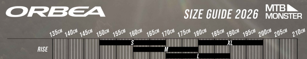

I'd not thought to look at Orbea, thanks. Will be looking at size larges as she's around 177cm.
177cm would but her at the top end of a medium or middle of a large according to Orbea's size guide (see below). I'm a bawhair over 180cm on a large Rise LT and it's perfect. I think that weighs just over 20kg but that's with the 630Wh battery, heavier duty tyres and longer fork (160mm Fox 36 Performance). So, a large SL should be lighter. To be honest though, I don't feel the weight of mine when riding it or even moving it around.
