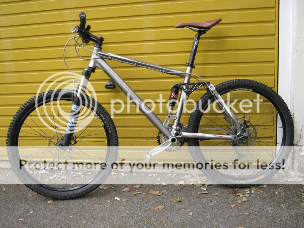

So, I was after upgrading the Rock Lobster Team Tig SL and fancied a move to FS for the first time. The RL had some decent kit on it so was only looking to upgrade the frame.
Stuck a wanted ad on the classifieds and was offered a couple of frames including a Boardman Team FS. Seems to get decent reviews for the quality of the frame as well as the spec so £150 quid or so later it arrived.

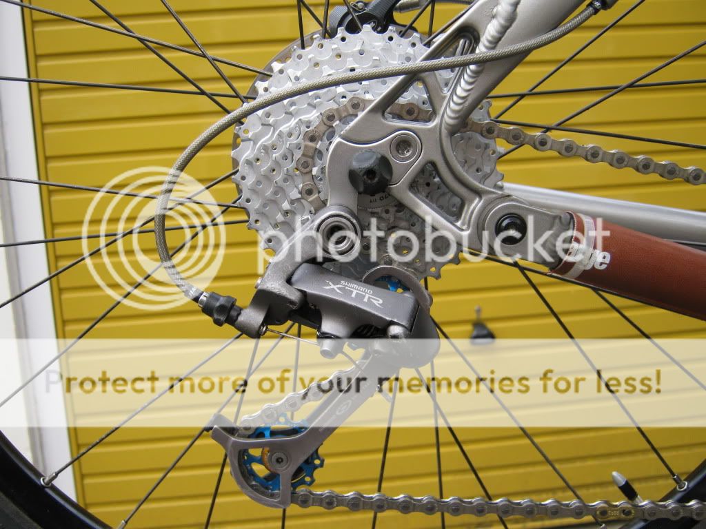

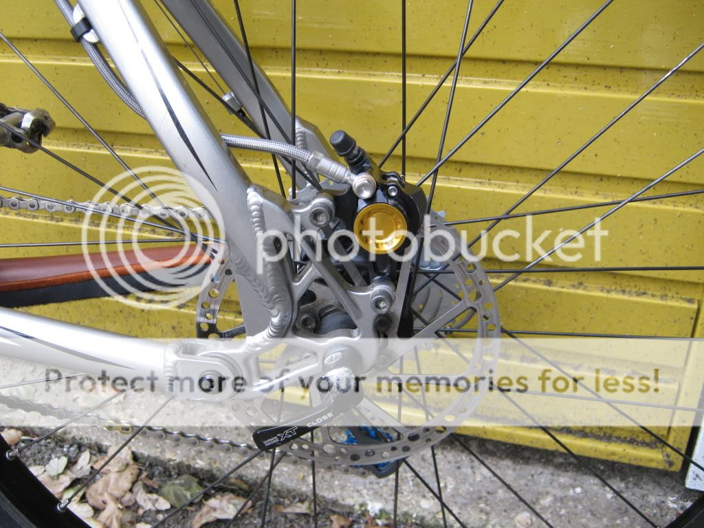

Built up with the kit off the RL made it a cheap project but also upgraded the hoses on my Hope Mono Minis to braided, a Jagwire gear cable set to match and a blingy Ritchey Carbon headset and it's ready to go...
First ride this morning and despite not having a great deal to compare it to I'm very impressed. Traction on loose climbs is greatly improved over the hardtail and some rocky chutes on the way down were a lot easier - off the brakes and float over rather than trying to control a back end pinging around... I've read some reports that the back end can be a little flexy but didn't notice anything adverse today.

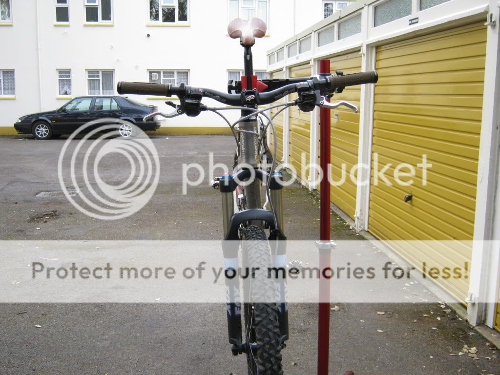

Wow, no garage door slagging, no beeing pulled up on the misaligned tyres (only noticed after I posted the pics) and no one has mentioned Halfords?

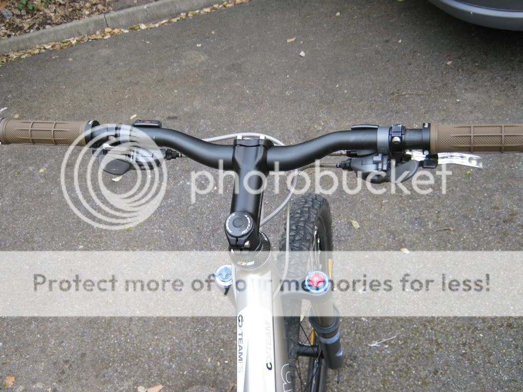

Whats with the brown saddle, grips and stay guard. Spoils an otherwide nice looking build. Oh and i would sort out that front brake hose before it catches on something 🙄

well, if you really insist..... I would have the grips on the other way up so you grip the raised crisscrossy bits with the ends of your fingers.

Just remeber to keep tightening the pivot bolts. Mine seem to need the odd nip up

Front hose length is as short as possible while still being able to remove the brake lever from the bars without removing the caliper.

JW, I thought about which way up the grips should go but the raised criss-crossy bit is actuall domed in the middle on these Superstar grips and falls into the palm of the hand really nicely.

Finally, thanks for the tip Tiger. I stripped the suspension apart before I built up the Boardman and put threadlock on all the pivot bolts so hopefully it will hold together, but I'll keep an eye on it...
