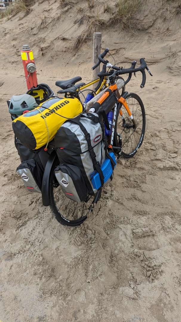

For the top of the rack I've generally used a large dry bag and a bungee.  This is from Holland a year or so back.  A week of clothes, cooking and sleeping gear for me and my son in April (so lots of layers/warm stuff for evenings) PXL_20240401_101813418.jpg

An option is to use front panniers on the back. Being smaller they are less likely to get heel strike. Ortlieb fronts are 15l each. I have done overnight trips with one front pannier and my sleeping bag/mat strapped on top of the rack, albeit bothy rather than tent.
https://ibb.co/XfLm7VPb
