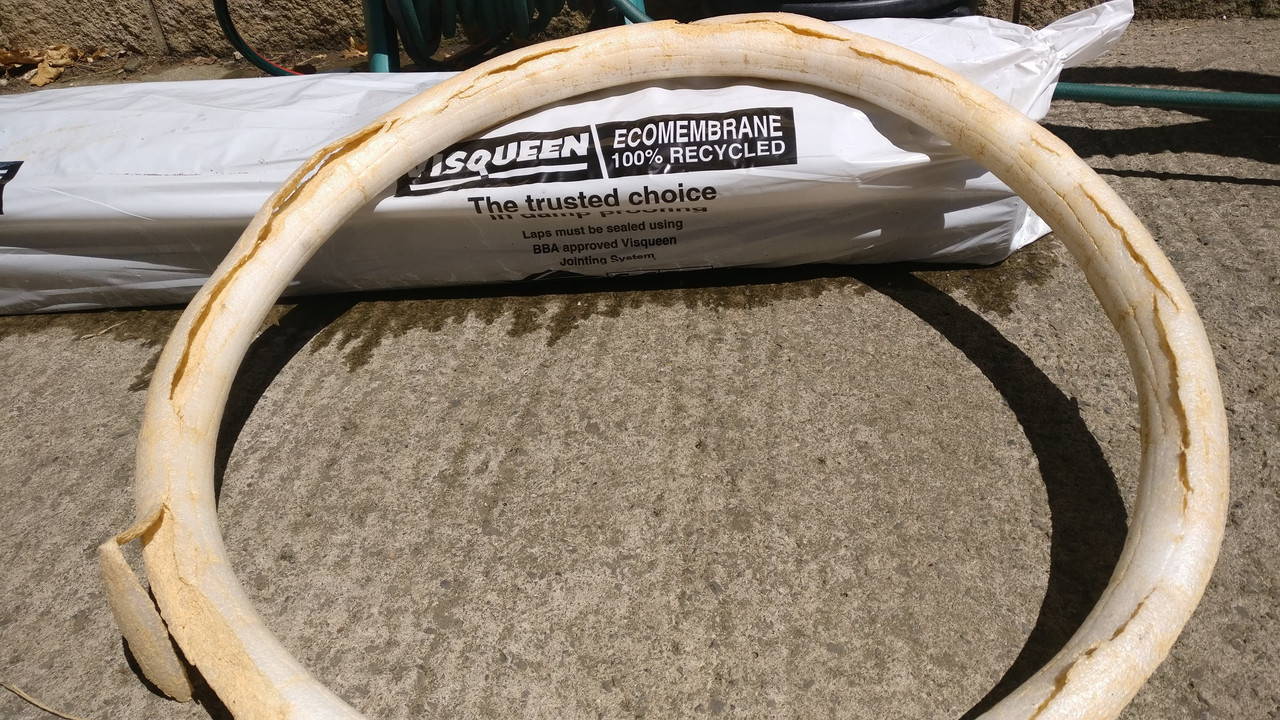

A couple of years ago on here there was a thread about bodging inserts on the cheap with some closed cell foam piping cut to length to suit the diameter of the wheel, as there was some agreement that shop bought inserts appear to be a very similar concept. The materials were a couple of pounds per set, but could only be bought in bulk from some trade foam places.
Any long term users care to give feedback?
There are now a few people on eBay selling the appropriate length of closed cell foam with a couple of cable ties for around £5-10 Inc p&p.
If the budget route does work well, then I can't decide if the eBay sellers are chancers, or if the big boys of foam inserts charging £50+ are the bigger chancers
If the budget route does work well, then I can’t decide if the eBay sellers are chancers, or if the big boys of foam inserts charging £50+ are the bigger chancers
I do this only because I'm a cheapskate
I don't run the whole thing, I cut it down the length so mine is a semicircle. Sits nicely in the rim. Have been running the same one for nearly two years. Two months ago I replaced the rear tyre and it shows signs of impacts in some places so It's doing what I'd hoped it would.
November 2017.
I played around with backer rod. It worked, but wasn't very durable.
backer rod
It was an acceptable alternative when there wasn't much choice on the market. These days, theres plenty of choice. I now use Rimpact.
