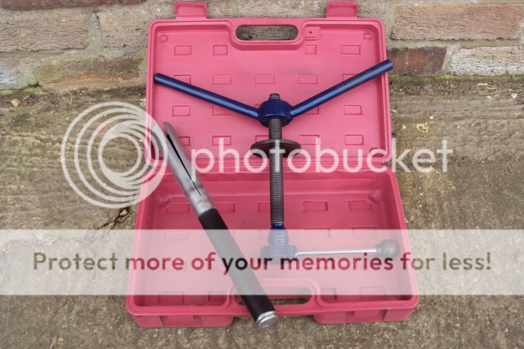

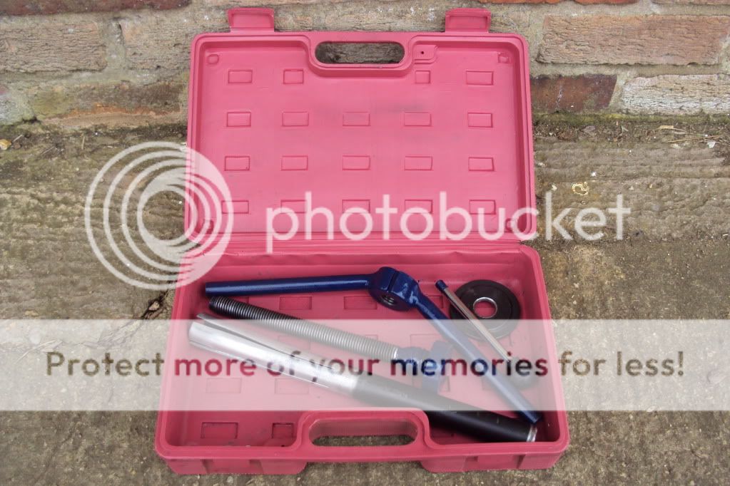

Made these today after this post inspired me. Remembered having a broken vice kicking about, some solid bar, a pillar drill handle and an old seat post.
[img] ?t=1270306424[/img]
[img] ?t=1270306446[/img]
Also managed to nicely grind a bit off my knuckle. 😆
[img] ?t=1270306539[/img]
Posted : 03/04/2010 2:56 pm
