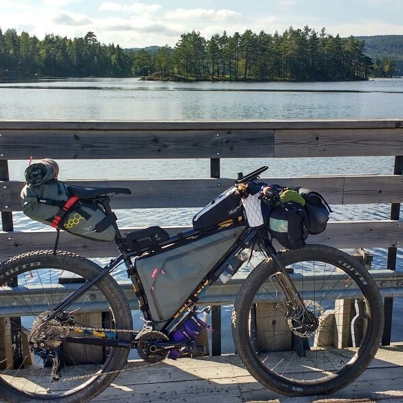

hollyboni, you mean like this, although it doesn’t have suspension forks:
Posted : 31/07/2018 8:08 pm

+1 for the Fargo which is also run with Jones Loops.
Keep Peddaling built a ti one which might be on their gallery.
The mtbr fargo thread has just about every combination of Fargo build in there somewhere.
http://forums.mtbr.com/salsa/salsa-fargo-thread-467422.html#post13760324
Posted : 04/08/2018 5:41 pm
Posts: 299
Ti456 here - brilliant touring bike - just spent 5 days cycling round Mayo / Galway on mine in July and was spot on
