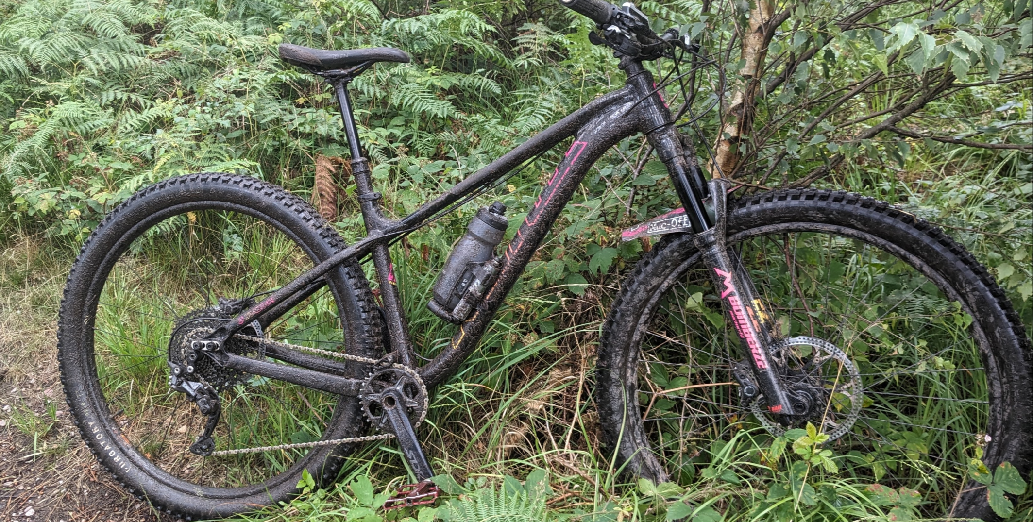

Posts: 1223
The Trek Roscoes are pretty good. I looked at them a while back but was put off by the 141mm dropout weirdness, but they've since gone to 148 and now make a load more sense. I do like a singlespeed, though.
Another option - albeit second hand -is what I have at the moment: a Specialized Fuse M4. Singlespeedable, nice manners, good finishes and a lot of nice little touches in terms of design and manufacturing. The only thing I don't enjoy is the seat tube bottle bosses are rivnuts, so I can't fit a longer dropper. Other than that, very nice for someone my height - note the stack on bigger frames is low, but hooge rise bars are all the rage these days....
It's intended for 130mm forks, though - which may make it a non-starter if you want more.

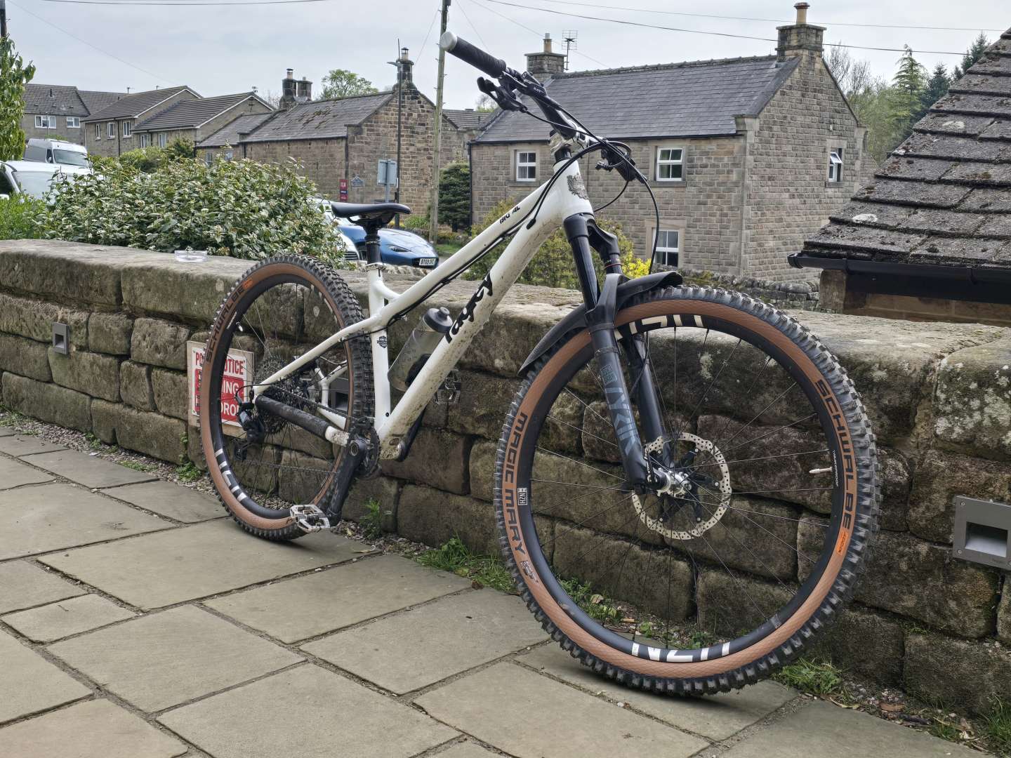

Yeah from 2022 onwards the Roscoe got updated geo, boost rear, 29" wheels and are now designed around a 140mm fork (warrantied up to 150mm).
I sold my full suss last year and bought the Roscoe 9 and it's an absolute beast which happily handles everything I rode the on previous bike (NukeProof Mega). It's quite hard to find the 9 now though, and I reckon 7 and 8 would require too many upgrades for an established rider (although I have upgraded my 9 just "because").
That being said, if I was building up a HHT from scratch them I'd probably start with a Cotic BFe,Stanton Switch9er or Transition TransAM.

  I have just moved from a Big Al to a Cotic BFE. Both running 160mm forks. The Big Al frame is hanging in the shed now, give me a shout if you want to make an offer on it (size large) and i can send you some more photos of the frame.

Last summer I built a Stanton Switch9er. Bit of a dream build. Stanton recommend 140mm travel (+/- 20mm) I went for 150mm fork coz more is better right?
I been out of MTBs for a while. My previous bike was a BFe 26er. Always fancied a 'hardcore' HT.
I am astounded how capable my Stanton is. Climbs well no wandering. Eats up the steep downhill stuff and absolutely fine for a day at BPW. OK it's steel, and a new frame is out of your budget. But frames turn up regularly. If this peaks your interest and if you're on FB they come up regularly on the Stanton owners group.

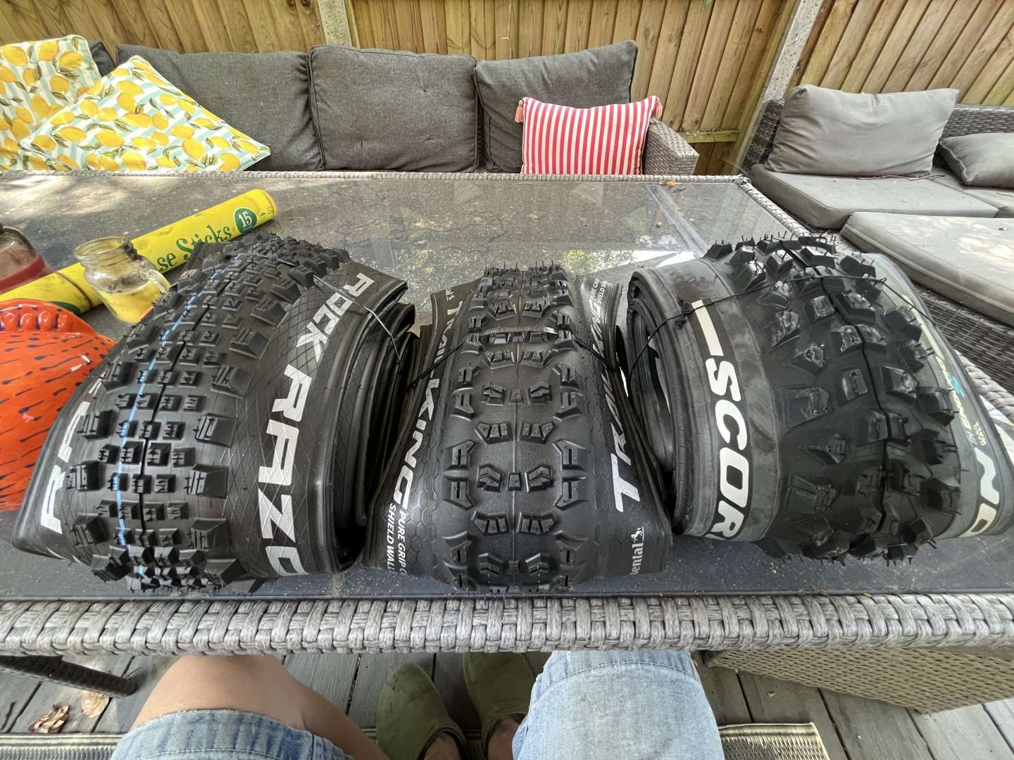

Thought I’d just unearth this one for some more advice from the tyre experts. The postie has just been and I have 3 quite different tyres to choose from for the rear:
L->R Schwalbe Rock Razor super trail, Conti Trail King Pure Grip, Pirelli Scorpion Enduro S (Hard wall).
All 27.5x2.6”.
For upcoming use (general summer trail riding) I’m currently favouring the Rock razor as it looks fastish, lighter and probably pairs well with the Nobby Nick on the front currently, but the Trail King is in the running. First appraisal on the Scorpion is that it feels like a more aggressive tyre, better for uplifts and big days out? Possibly a candidate to fit to my planned second rear wheel(?).
input and criticism from the collective please…
Posted : 15/08/2025 11:57 am
 Yak
Posts: 6939
Probably the rock razor unless you are going to put a grippier tyre than a NN on the front.
Posted : 15/08/2025 12:34 pm
Posts: 6783
I have a Rock Razer on the back of my hard tail, 2.6. It was meant tho be a summer tyre but it's been on for 18 month because it's ace and I've never needed more.
Posted : 15/08/2025 12:38 pm
