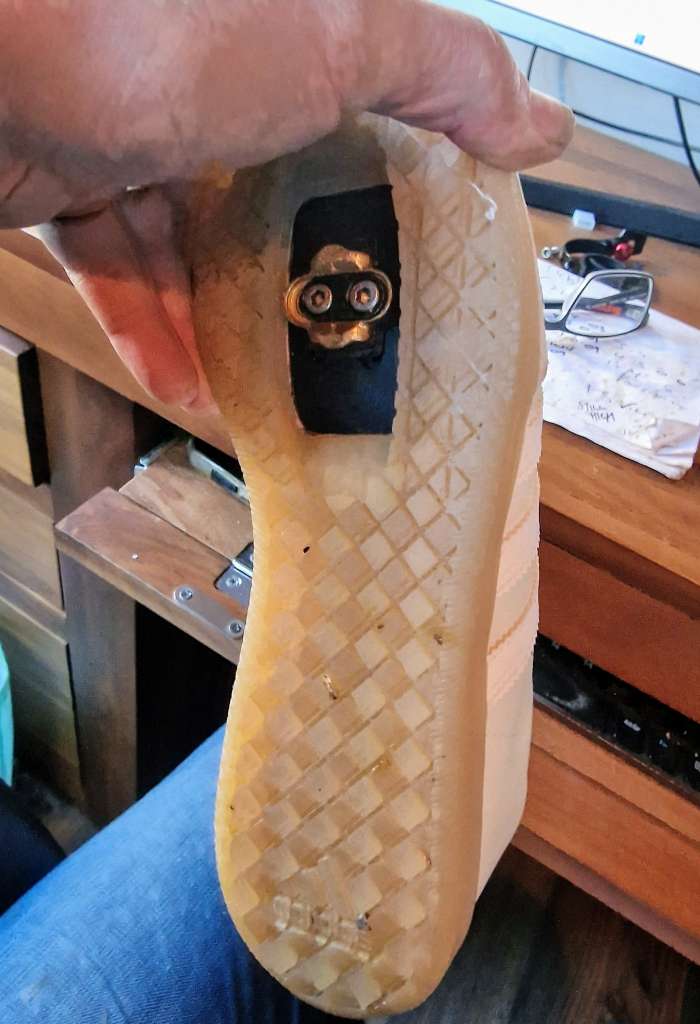

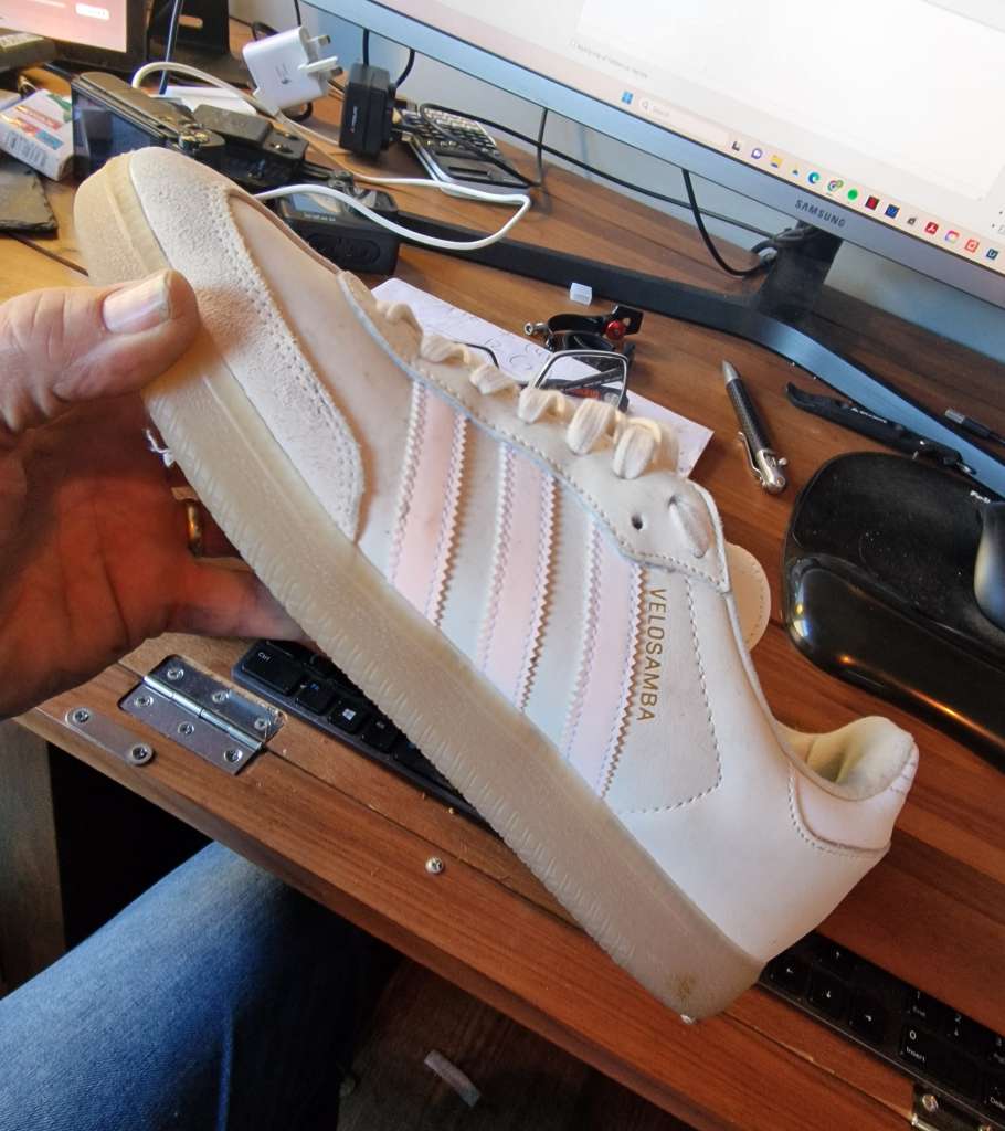

However, one thing that appeals about the mallet E is that it sounds like you can use them as flat pedals in a pinch for going down to the shops, etc.
Yes, not 100% ideal, or particularly comfy, but I've ridden my bikes many times to the pub/shops etc wearing normal trainers
Or get some Velosambas
20231201_120746~2
20231201_120750~2
Posted : 01/12/2023 1:06 pm
