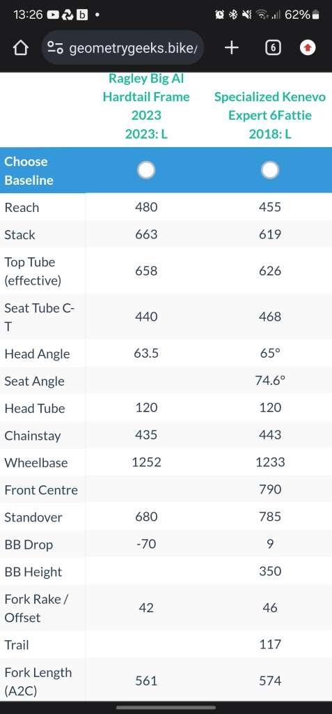

Building up my Big Al has just destroyed everything I 'thought' I knew about what geometry I liked.
I like my reach short with high bars, so was worried that the Big Al having a longer reach would feel too stretched out. The combination of 29'er, low BB and whatever else is going on - it feels perfect.

@v7fmp
The Kenevo has changed a bit though - now has a 29'er front end, so shorter etc
Screenshot_20231201_132617_Chrome
