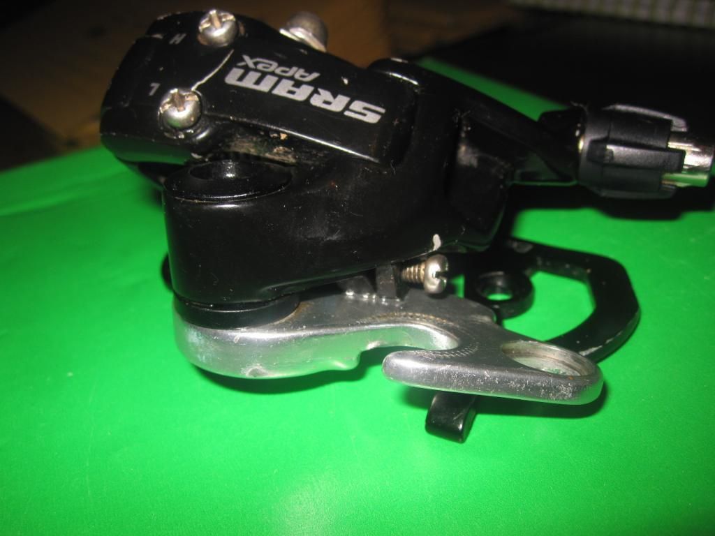

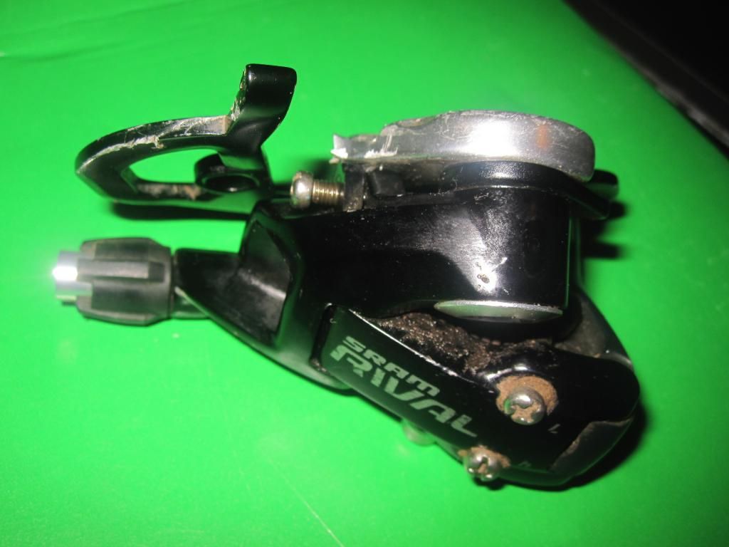

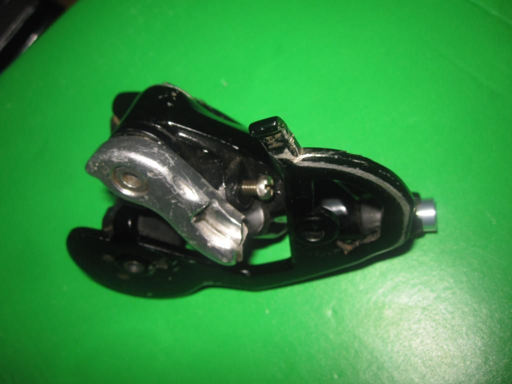

I've got two rear mechs that have broken hangers still attached. I think they might be jammed?
the mechs them selves look ok and move freely - although the outer cages are bent.
how can I remove the hangers and will the mechs work ok with new cages?
thanks

Can't you just whack a hex key on either side and unscrew?
Posted : 16/12/2012 5:35 pm
 P20
Posts: 4252
They should just unscrew. You may need to hold the dropout in a vice though
Posted : 16/12/2012 5:36 pm
Posts: 14707
Indeedy grab drop out with vice or big pair of grips & undo the allen key holding the mech on
Posted : 16/12/2012 5:55 pm
Posts: 2176
....and then adjust your lower limit screw.....
