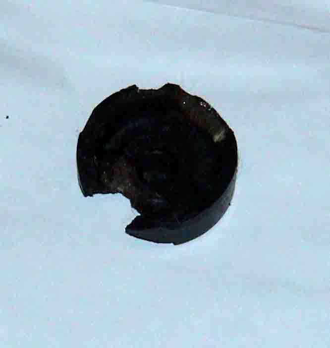

Posts: 12351
Posted by: scotroutes
Imagine braking using the piston...
