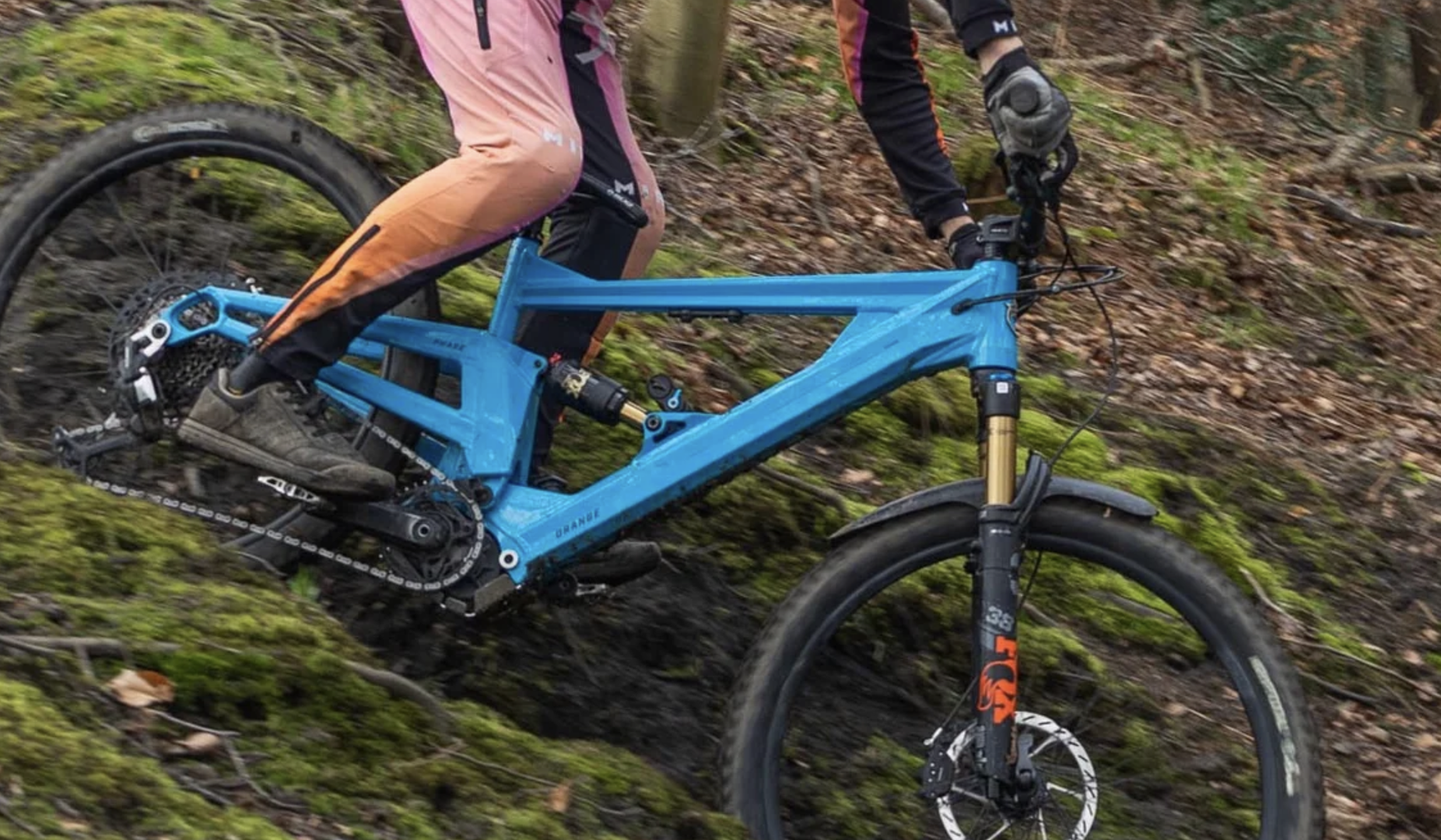

https://orangebikes.com/pages/phase-avinox-model
Like the look of that. Hides its e-bikeness better than most and seems to be right up there in the power stakes although I'm no expert? Will defo be on my list if and when I make the move to electric.

Posts: 14314
Not developing suspension kinematics post 1990's when every other manufacturer has done?”
If you actually study kinematics you’ll see that the suspension behaviour of Orange bikes over the last 10+ years has been very good.
The anti-squat is in an excellent range for good pedalling without excessive kickback, the brake squat holds the geometry in shape better than most four bar designs without being so high the rear brake locks things almost solid like on more fashionable high pivot bikes, the leverage ratio is essentially constant and not regressive, and low enough to be easy to damp and reasonable shock pressures or coil weights for bigger riders - if you go big add volume spacers and/or high speed compression and/or hydraulic bottom out.
And the resulting frame weighs less and is easier to maintain than something with more links. The only real downside is fitting a water bottle in - and comments on kinematics from people who don’t understand how this stuff works.
I don’t ride an Orange, I ride a four bar Specialized and I wish it had higher brake squat like my old Banshee (which was a four bar short link design) which had similar brake squat to an Orange. But I do prefer my bike’s more linear and less progressive linkage vs that Banshee - so an Orange would be good on that front.
But I like having a bottle on an ebike - it works so well with the big downtube keeping it clean!
Since about 2015 most full-sus bikes have had pretty decent kinematics. But before then, four bar (Horst link) bikes were all over the place, some ok but also so many bad decisions in pivot placement etc, wallowy pedalling, no midstroke support when you hit a been or jump, wiggly curves making it hard to feel what the back of the bike is doing. A single pivot with the main pivot and ends of the shock in the right places just works! Harder to sell though…

Posted by: chiefgrooveguru
Bottle bosses on the underside of the toptube on this Orange - that's definitely a Fidlock bases:
