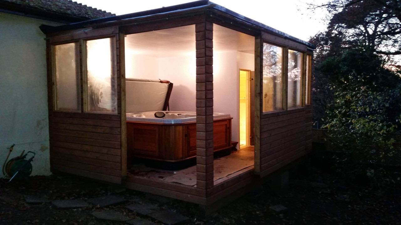

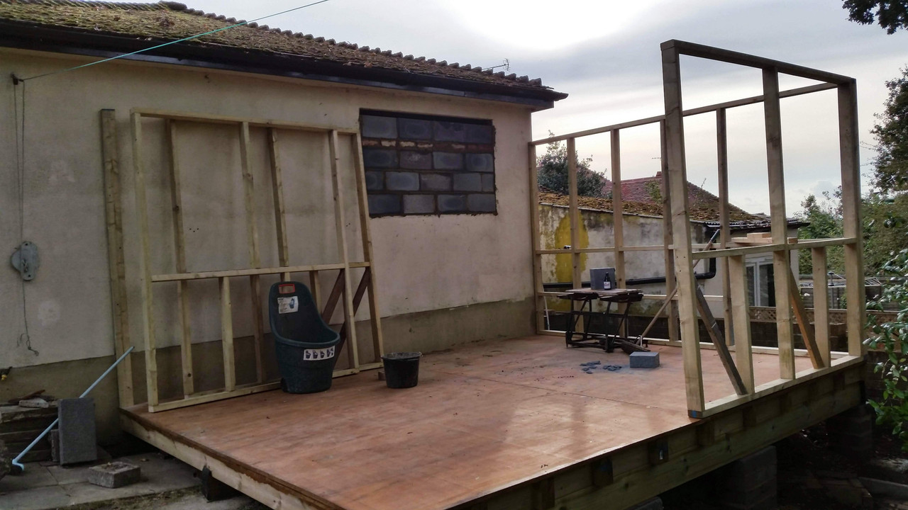

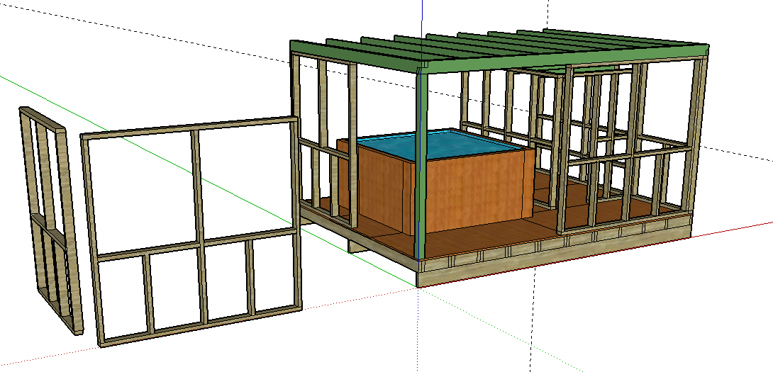

    I did the cabin design and build of this having never previously build anything more substantial than a shelf. I was careful to make the dimensions fit standard wood lengths to minimise the amount of cutting and risk of errors but here is it in the free drawing/planning tool I use, Sketchup. I bought a 2nd hand table saw for cutting long stuff and a cheap(ish) chop saw for quick and accurate cross cuts – I could have got away with a hand saw but wanted easy life and tools. The surprise to me was the router which I thought was a luxury by I used it for all the window beads, the trim pieces and to generally make the job looked finished – it paid for itself on day one by turning rough cut timber into the quartic window bead to hold the glass in, quartic beads for 6 of the 8 windows was the cost of the router.
    Here is it part built with the two sliding doors leaning agains that garage wall
    And here it is complete. About 8 weeks to build witht he help of MrsWCA and still standing just fine many years later

    Built this ages ago but going to clear some space and build a workbench in my garage to do more intricate stuff.
    dyna-ti
    @Surfer.
    That’s lovely. I like the folding double doors. Makes for a good open yet enclosed and covered space for outdoor/indoor bbq parties.
    surfer
    The doors were free. A friend got 3 sets from a company that tests their security and provides kite marks so they were expensive new but had lots of damage that had to be repaired. I just built the rest around them.
