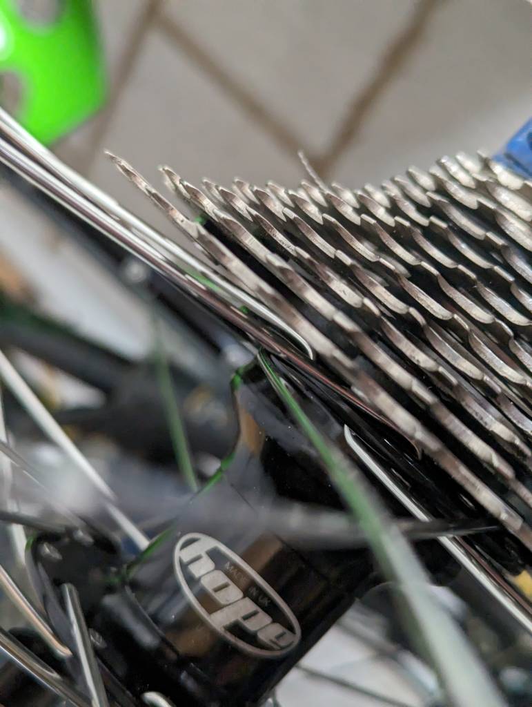

As an update, I shaved the free hub body down and built the wheel this morning. Works well, there is maybe only 0.3mm clearance between the back of the cassette rivets and the spokes though, was below zero till I dished the wheel
