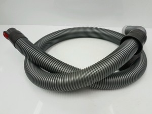

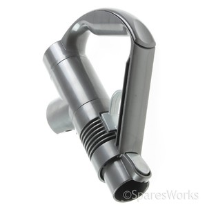

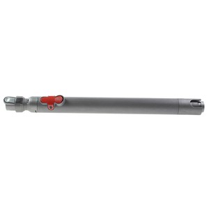

Posts: 2418
Poolman - which bit of the hose did you bypass?
I already have this bit:
But guess I need to get both of these:

Posts: 1108
OP - you are in luck! I have a spare dc19 wand tube (your second pic above) which you can have for nothing if you want. I don't have the other bits though I'm afraid.
It will definitely fit your machine if it says T2 (I could demonstrate some rather sad product knowledge here but I'll refrain...)
