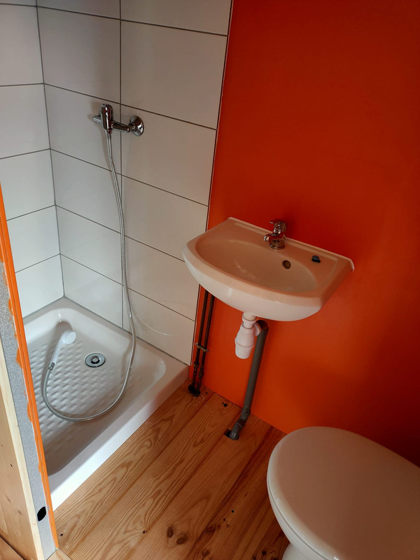

Posts: 18587
Built to fit around an 80cm shower tray, a tiny hand wash basin an a toilet. 80 x 200cm with a sliding door. The toilet is on slight angle so I don't bang my leg on the basin getting up. All works fine.

Posts: 18587
And a pic when it was nearly finished. Hardest part was the plumbing, getting hot and cold water to it and a proper 100mm waste pipe with the right fall away. As with many things it's what you can't see the takes the time and effort.

Posts: 18587
I did think about that, the sink is bolted through the wall and makes a solid hand hold. The sliding 90cm door makes for easy access. If ever there's a need for wheel chair access that'll be the main bathroom with a partition knocked out.
