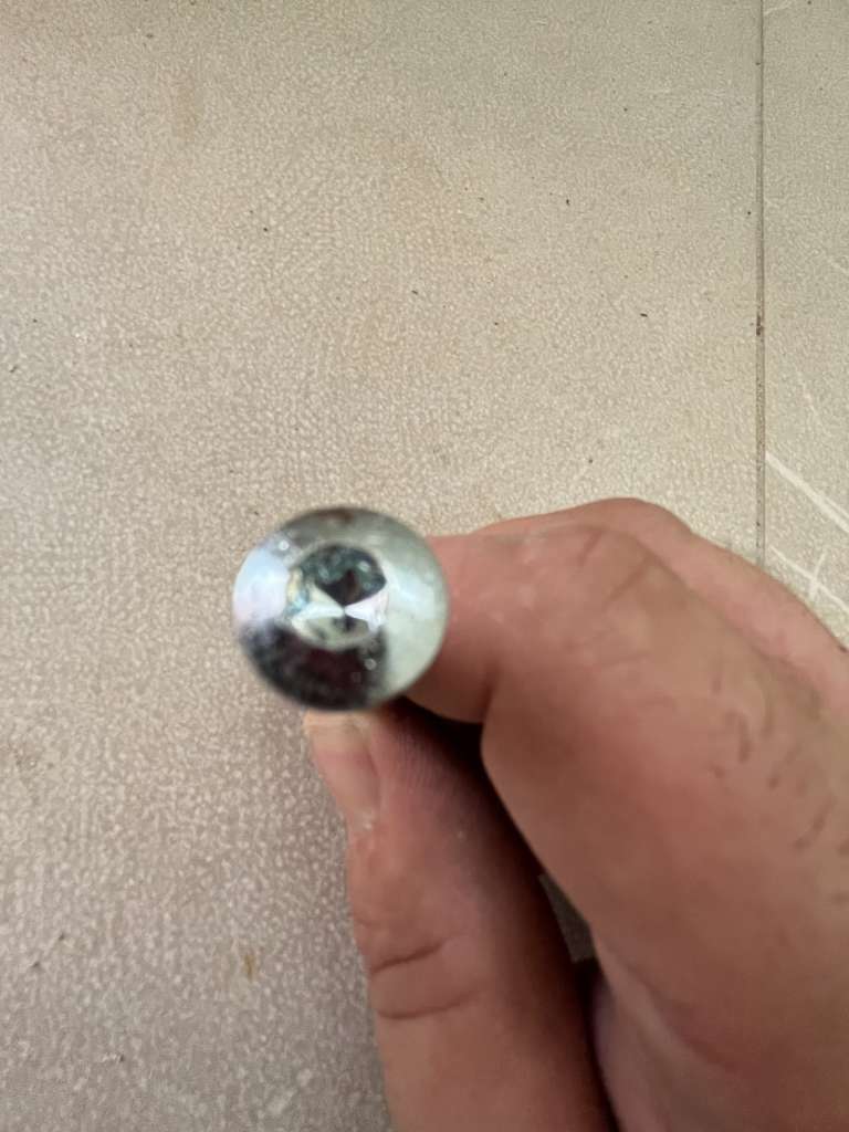

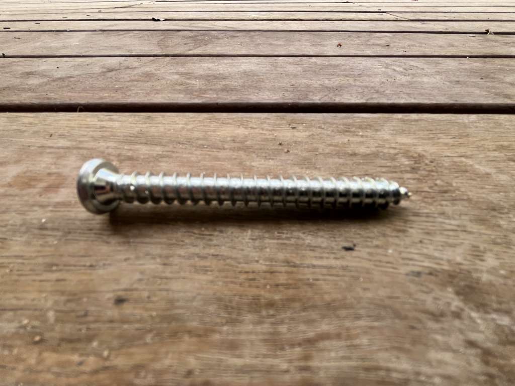

What screw is this?
I know it’s 70mm, it’s made by Würth, and I think it’s zinc plated. But I can’t find it in the catalogue.
Due to the f$@kwittery of a fire screen supplier I have 2500 of them that I don’t need, can’t return and will sell them on, but the boxes aren’t labeled…

Button head, counter sunk screw.
Posted : 10/12/2023 6:31 am
Posts: 4722
Button head, hex socket, not fully counter sunk, some sort of wood screw.

Yeah, it’s definitely not fully countersunk.
Posted : 10/12/2023 7:38 am
Posts: 12894
It's not a button head and I would disagree about it being countersunk aswell.
It's designed to bury itself below the surface of the wood completely. Like a decking screw.
Posted : 10/12/2023 7:43 am
Posts: 7094
Single thread.
Not countersunk. But, what joshvegas said, will Bury the head.
Maybe intended for sticking panels of osb to studding?
Posted : 10/12/2023 8:04 am
Posts: 380
Looks like it could be a concrete/masonary screw. Never seen a wood screw with Allen head before, usually pozi/torx

It’s not quite hex head but AW, like a tapered torx.
Posted : 10/12/2023 8:56 am
Posts: 6600
Out of focus raised head, for use with a worn-out bit
Posted : 10/12/2023 8:59 am
peterno51 and peterno51 reacted
Posts: 7271
Pan head
Single course thread
Hex driver
Shoulder design appears to be job specific due to chamfer and not splined , Ie. for self counter sinking

It's not a pan head or it wouldn't have the cone.
It's not a hex drive... Because reeksy says it's AW.
I will allow the other two points though.
Posted : 10/12/2023 9:39 am
Posts: 4626
I think that type of screw is for fixing metal plate to wood as in tie plates for roof joists etc. The socket is probably RW type, not sure what the screw is called though.

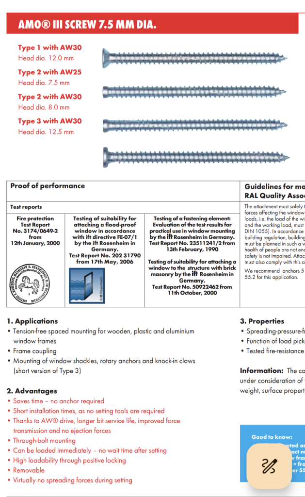

A Worth Amo III 7.5 type 3 (12.5mm head)
https://www.wurth.se/ecom/globalassets/inriver/resources/55-1_c50b0598.pd f">Like this.
Whether it's correct or not I am definitely wrong about it burying in wood (it would do that but not what is for)

A Worth Amo III 7.5 type 3 (12.5mm head)<br /><br />
This might be close… except I can’t get the internet to work to verify it.
I think it’s not actually a wood screw at all, but for fastening metal to metal.

Posts: 18164
The head looks quite different to any of them. It's domed.

See I thought that but two things.
It's hard to tell from reeksys pictures how domed it is.
Looking at the other heads in that spec sheet it looks to me like it's been brutally cropped. Infact the only photo worse than the one in the spec sheet is Reeksys In backgrounds with a blurred centipede in the foreground.
I haven't just taken a flyer at it I developed quite the search term... And applied the use case to my logic.
It might be something else though. They don't seem to be available on the UK site so may be discontinued and this is a replacement.
I am confident I am more righter than anyone else so far though.

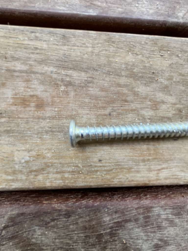

I think you’ve nailed (or rather screwed) it.
It’s supposed to be fixing fire screens over windows, well it was six months ago. We changed our specifications but they still sent them and the supplier a royal pita to deal with.
Also, I try so hard with this bloody iPhone to take close up photos and it just always focuses on the wrong thing regardless of what I tell it!

Pretty certain it’s these buggers:
https://eshop.wurth.com.au/Product-categories/Amo-III-type-1-steel-zinc-plated-RW-30/31024508020101.cyid/3102.cgid/en/GB/AUD/

Presumably the angle under the head isn’t a countersink, it’s a taper for centring a metal sheet where the sheet’s hole is ever so slightly larger than the screw shank width. The head then hits the flat of the metal sheet holding it down (up/across delete as appropriate).
Edit - given the width of the shank, thread, taper and head I’m pretty certain - though admittedly often wrong.
The countersunk milling head isn't obvious in your photo if it those
Posted : 10/12/2023 1:05 pm
Posts: 12894
Yeah deffo the type 3 not the type 1.
Jesus I need to step away from this.
Yep, you’re right. @joshvegas perhaps I could send you a couple as a memento?
