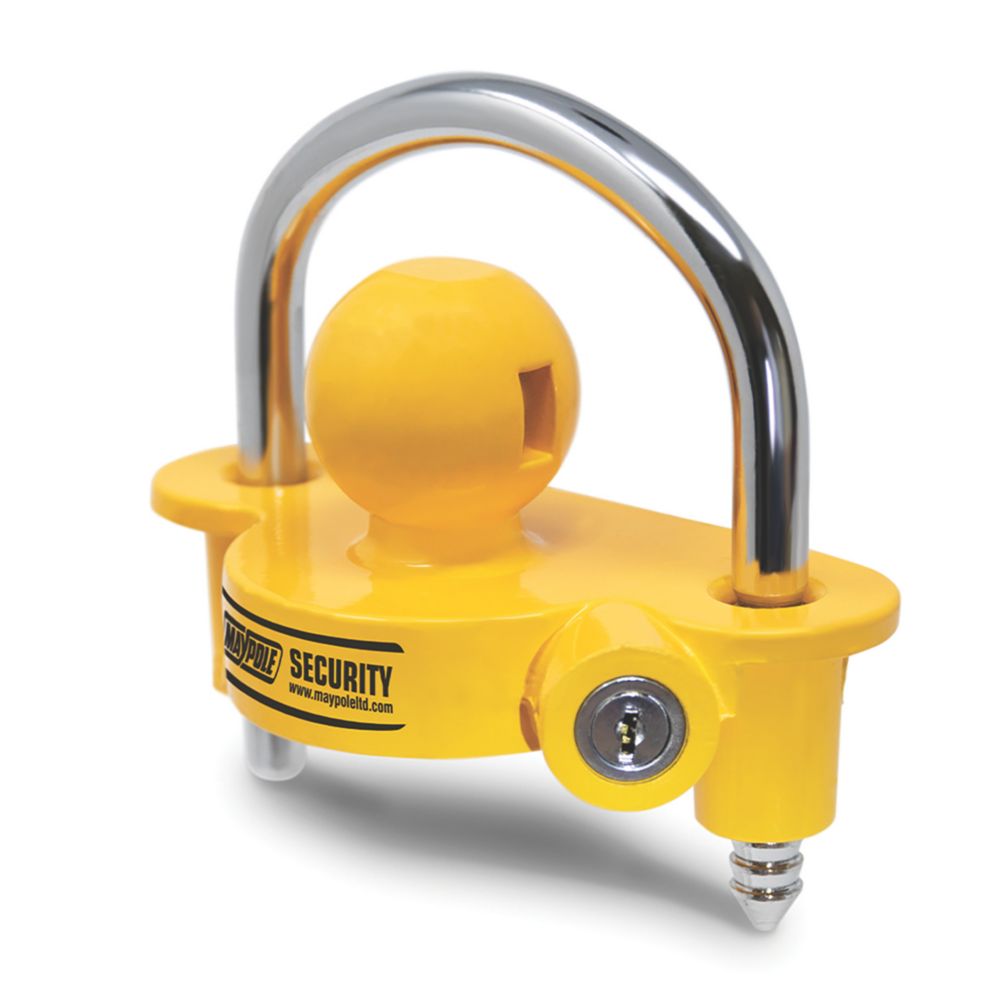

Posts: 1500
hitch lock
A simple hitch lock (£15 from Screwfix) on our small camping trailer. At home it lives in the garage, it's more of a deterrent when pitched up to prevent someone making off with an empty trailer. You'd have to destroy the hitch to get it off therefore rendering the trailer pretty useless to an opportunist.

Posts: 525
You’d have to destroy the hitch to get it off therefore rendering the trailer pretty useless to an opportunist.
Unfortunately that’s wishful thinking. That would be off in 2 mins, the only thing damaged would be the lock as it’s dumped on the floor/nearest bush. But also they don’t bother removing hitch locks, they have a hitch with a bracket thingy on it that just hooks under/over the hitch lock and off they go. Hitch lock to be removed at leisure.
Lash any hitch lock on to deter an opportunist, but don’t expect it to stop a ‘proper thief’
