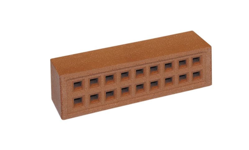

Never seen a n air brick like that before.
will you remove the felt cladding?
have yo though about how you will insulate the new cladding?
Posted : 20/07/2011 9:14 pm
The air brick is one of these;
[img] http://s7g1.scene7.com/is/image/BandQ/5012016171457_001c_v001_zp?$160x160_generic$ [/img]

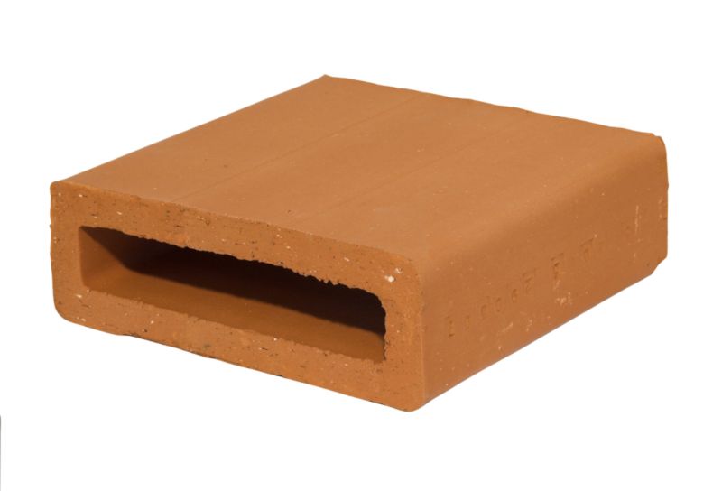

With one of these behind;
[img] http://s7g1.scene7.com/is/image/BandQ/5012016171471_001c_v001_zp?$160x160_generic$ [/img]
