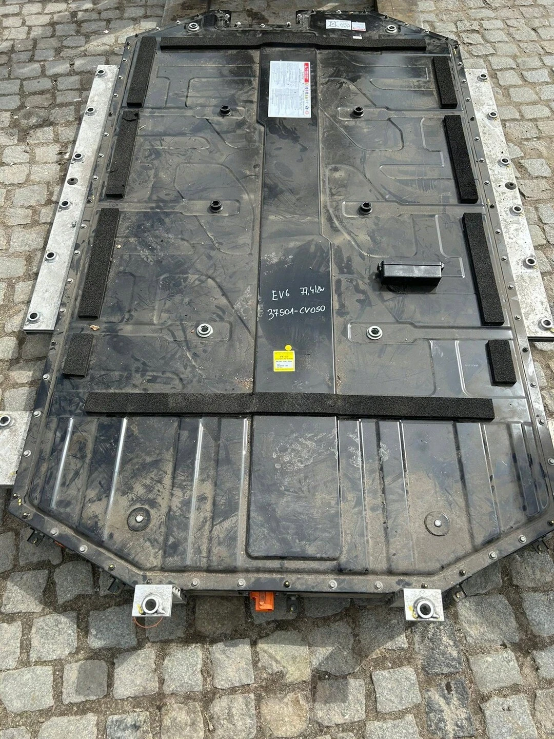

Posts: 91159
The amount of electronics is about the same in ICE and EV, however EVs have the inverter and associated electrics under the bonnet. However there is very little heat and vibration under there. I drove 2hrs on windy roads, then when I stopped I put my hand on the inverter engine and it was barely lukewarm. Compare that to the heat and vibration your ICE electronics have to put up with.
The battery can be structural but that doesn't mean it's part of the chassis itself, it's just a chassis member - and it can be removed. How do you think they get it in there?
This is a complete Kia EV6 77.4kWh battery listed on eBay (for £3.5k) alongside all the other car parts for everything under the sun. Looks like it's just dropped out from underneath, you can see the fixings around the edge.
A replacement engine for my Merc is £2k many years older than this battery, and considerably more work to replace. Thinking about it, someone needs to come out with a way to make this into a home battery because that's vastly cheaper than what's on offer!
Posted : 14/10/2024 10:29 pm
