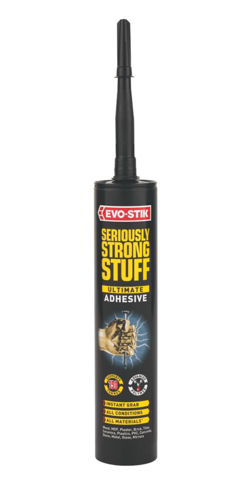

If I were you I'd get hold of a bit of caravan awning bead track. I needed a replacement section for a caravan, so I went to my nearest caravan breakers and they sold me loads for cheap (unlike the rest of the stuff they sell!) You could glue it on with something like [url= http://www.screwfix.com/p/evo-stik-serious-stuff-ultra-power-solvent-free-adhesive-white-290ml/85825?kpid=85825&cm_mmc=Google-_-Product%20Listing%20Ads-_-Sales%20Tracking-_-sales%20tracking%20url&cm_mmc=Google-_-Shopping%20-%20Sealants%20and%20Adhesives%20(New)-_-Shopping%20-%20Sealants%20and%20Adhesives&gclid=CjwKEAjwpqq6BRC99aKUkaSjuDsSJAC0pNTVR9m4n3CNel_yIywyPb4ReGzHEs3jVlKJzuUmDXMONBoCLHHw_wcB ]this[/url], which is absolutely bonkers strong:
[img] http://s7g3.scene7.com/is/image//ae235?src=ae235/85825_P&$prodImageMedium$ [/img]
