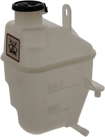

Posts: 3521
Thanks for the various comments, it gives me a bit more to go on.
Current plan is to do a coolant change, it's def overdue, and I've no idea how long it's been low (what better way to spend boxing day), then monitor a) the smell b) the coolant levels.
To cover a few comments/questions...
  • I'm certain there's nothing spilt/lost inside the car
  • From what I've seen there's no silica gel in the expansion tank on this model
  • I think the cracked expansion tank problem is more of an issue on the "S", this is a One, but I'll def give it an inspection when cleaning it out
  • The cap on this expansion tank just clips on, it's not a screw on one, I think it's specifically designed that way - looks like this

Posts: 14275
Posted by: verses
That doesn't look like it's meant to hold any pressure anyway so probs discount that.

Posts: 3271
I'd be mistaking that for the washer reservoir, glad they put a sticker on it 🤣

Posts: 2032
"Not sure where the fluid has gone though. I checked the oil and that all looks normal, so it's not making its way into the engine. I guess it could be gradual evaporation, the expansion tank lid doesn't seem like a solid fit."
2 comments - the cooling system on these Gen1/Gen2 mini's is notoriously bad. So I'd say its unlikely your coolant level is dropping 'just cos'
The water pump (drivers side of the engine on a UK car) and thermostat (passenger side of engine) and crossover pipe where it enters the water pump housing (below the intake manifold at the rear of the engine) are likely / common failure points.
I've just replaced the upper rad hose on mine, so I've been reading a lot about the cooling system,
Also - your coolant cap doesn't sound like it's OE - these are pressurised systems. OE is definitely a screw cap (conventional for an expansion tank)
are you sure thats not the washer fluid cap? (which is more like you describe)

Posts: 1479
Posted by: thekingisdead
The sticker on the side of the vessel in the photo certainly implies "Not washer fluid", red cross and everything.

Posts: 3521
So....
On Boxing day I disconnected the coolant hose opened the filler cap, the cap on the expansion tank and the various bleed valves.  Plenty of hideously coloured water drained out, however the water I'd topped up the expansion tank with stayed put!?
I removed the tank, poured the contents out and disconnected the hose. The hose was full of crusted gunge preventing fluid from flowing in either direction.
I cleared it out by using some old washing line through it as a pipe cleaner.
After a couple of flushes I filled it back up with coolant and after a couple of runs there's no evidence of any leaks and the level in the coolant tank is raising and dropping as normal.
Not sure how long it had been like that but the coolant not having anywhere to expand to must have been putting undue pressure on the engine/rad/etc. 😔
After it had had a decent run I checked the rad and only the top half is getting warm. I assume it's still half full of gunge. Also, the smell was still there to begin with, but seemed to be fading towards the end. It'll need longer to know for sure whether it's helped it or not.
It's in a better state than it was when I started but def still needs some TLC. I'll keep an eye on the tank over the next couple of months and unless it needs anything sooner I'll do a more thorough flush (there's various chemicals available) and refill in the spring.
Looks like the thermostat isn't a bad job to do, although I'm not convinced it's failed. My dad suspected it might be the cause of the rad not getting fully hot.
Cheers for the input 👍
The tank on the S is different to the Cooper and the One. I assume you're more familiar with the S.
