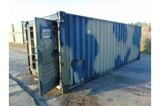

The neighbours won't even be able to see this one
EX army and looks tidy [url= https://whitelabel.globalauctionplatform.com/en-gb/auction-catalogues/wca/catalogue-id-witham1-10000/lot-09a06a76-69d0-42c7-8909-a70500c4cd75?clienturl=wca ]linky[/url]

I can't see anything in that photo apart from what looks like an empty storage yard.
