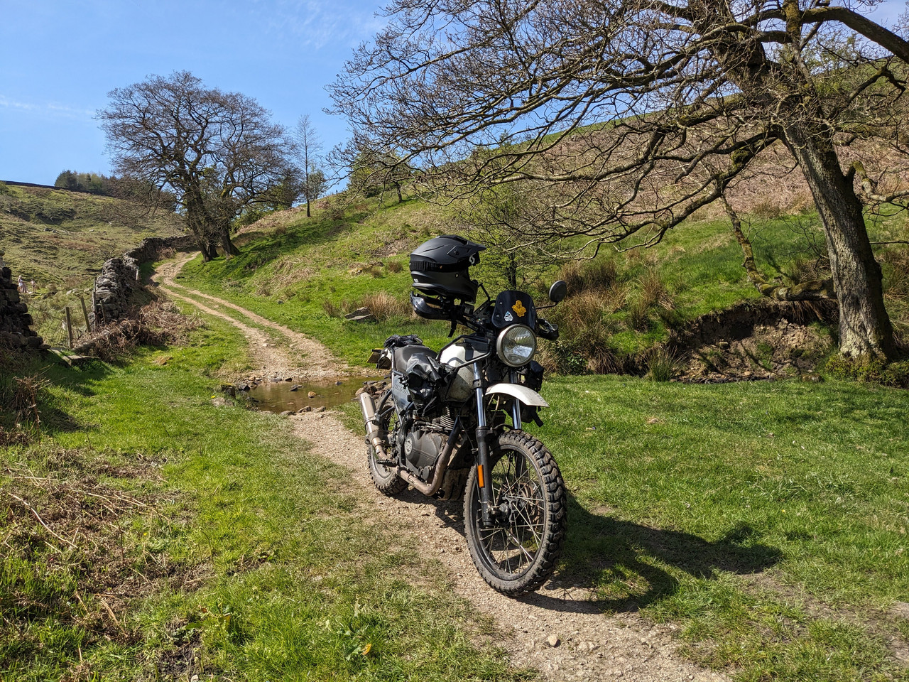

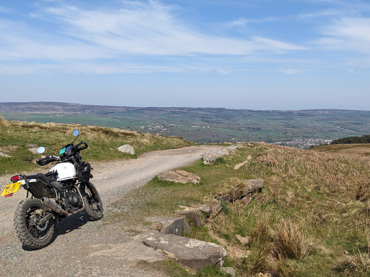

Currently running. Broke down on me in the Peak District the other week. Tested everything. Can't find anything wrong.
Intermittent innit 😐
Glorious day today
