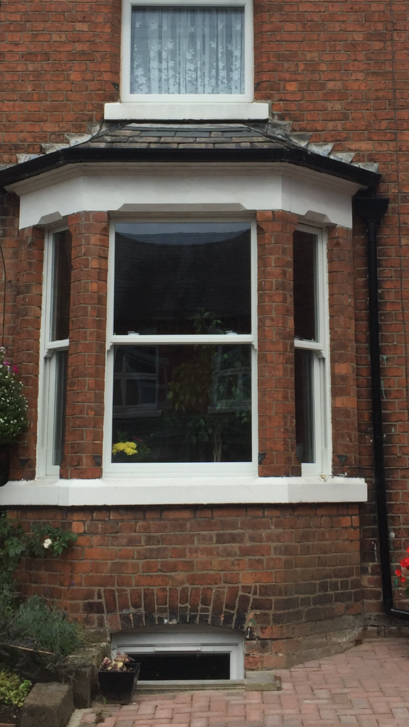

I'm thinking about swapping out my front bay sash for UPVC. I know loads of people have had this done. What's been done with the internal wood? Did they cut out or swap for new wood?
Behind the photo below is a stone section in the front bay.
[url= https://lh3.googleusercontent.com/4y1chXzVJdjVEs_NGzmAyqtqJu-MmXXz498MWB1DvAs_PZvjKce20JHMFYK-vvdTO-9-XolRi1OQ=w533-h712-no ]inside view[/url]

Mate are you sure you want to do that?
Posted : 23/10/2016 2:59 pm
You'll get complete new upvc frames so no wood at all (if they do it correctly anyway)
Posted : 23/10/2016 3:13 pm
Have you considered refurbing the sashes?
Posted : 23/10/2016 3:27 pm

Don't do it IMO. Your picture appears to show sound wood that needs a scrape, fill, sand, primer, undercoat and top coat. 4 days work and they will look like new - all for less than £50.

You need to make that the structure of the bay will take the plastic windows. The frame of the sashes is usually part of the overall structure and the plastic doesn't do the same job.
As noted above, make sure you aren't in conservation area.

As mentioned above, very often wooden frames support the building structure, it's not uncommon to see upvc'd windows in a bay or brickwork that has sagged as a result. Upvc's often rubbish for security, it flexes, depending on its exact construction, to the cost of one neighbour last year- a lot harder to break through timber framing...neither stand up to a brick through the pane (as happened to a friend recently).
They just put in a timber frame between the units, if needed.
uPVC sashes are permitted in Conservation areas it's how they look rather than what they're made of.

They age terribly
I'd say they age better than wood. Mine are 20 years old, as white as they day they were installed (once I wipe the dust off them). Wood would have needed painting at least twice during the same period. My front poor (wood) needs repainting at least every 5 years as it gets the sun and not found a modern Gloss which can cope with direct sun lights for more than 2-3 years before cracking.
