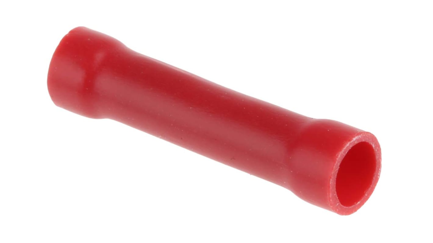

I've got a bunch of crappy wire connections that I want to remake on my boat (so generally all 12v fairly low power/thin wire type stuff) and I need/want a new crimping tool.
I'm going to stick with old school mechanical butt connectors with a separate shrink over the top rather than the solder type as I've not had the best experience with the latter.
So what should I be looking for that's going to do a good solid job?

I'm going to stick with old school mechanical crimps butt connectors with a separate heat shrink over the top

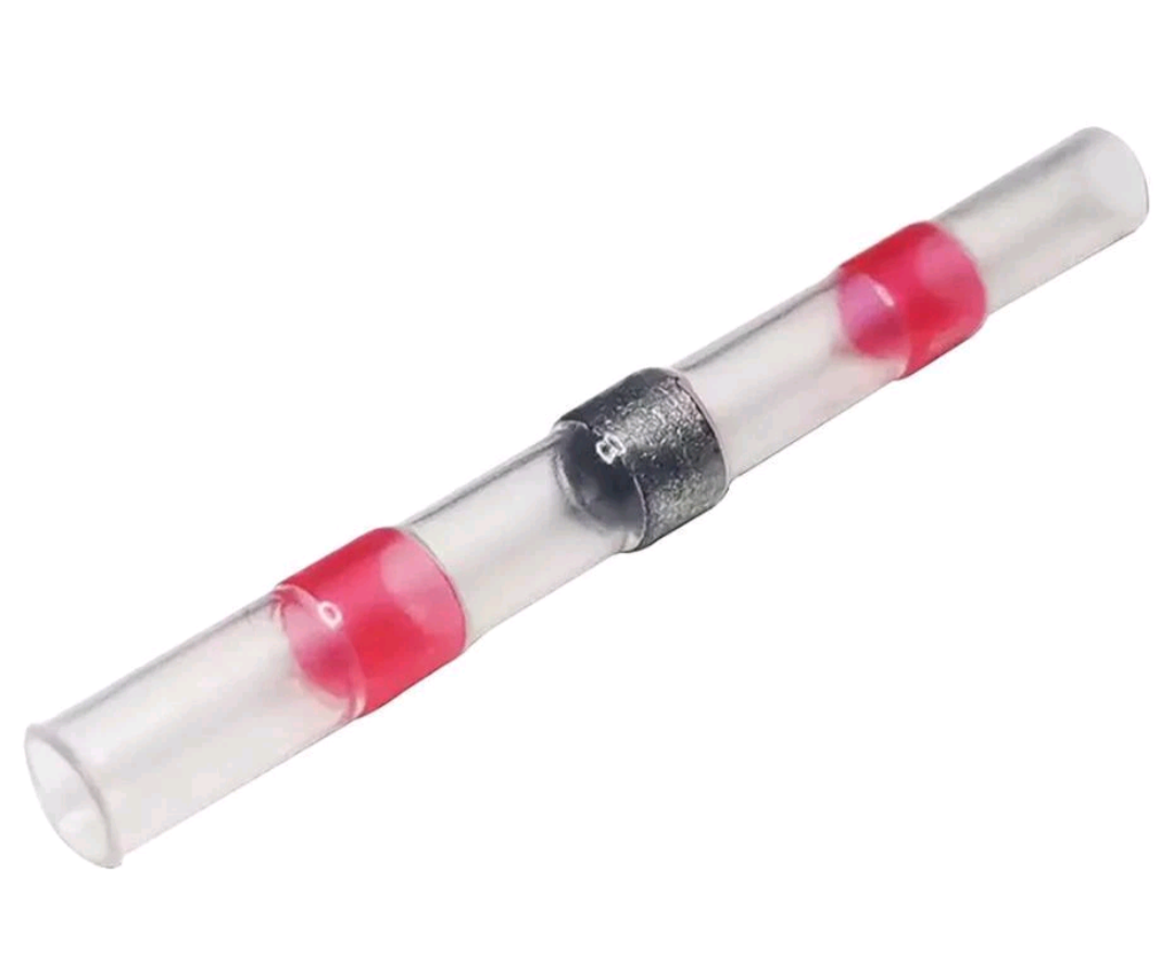

Solder seal connectors.  Wire in each end, heat, rejoyce.
Eg,
https://www.amazon.co.uk/Gorffy-Connectors-Automotive-Electrical-Waterproof/dp/B0BPMH8DCS

Oh blood and stomach pills.  Here:
Connectors
Posted : 06/02/2026 1:58 pm

Hmm I don't know what sort of vibration you get on a boat but for automotive connections Vehicle Manufacturers, and their suppliers, prefer crimped connections.
Solder creates a hard/stiff section in the wire. The hard/stiff section creates a stress-raiser in the flexible cable. Given sufficient vibration, that can lead to fatigue failure.
So crimped connections are superior in automotive (and maybe boat) scenarios 🙂
YMMV etc...

🤔 A butt connector generally has a longer, stiffer section than one of the newer solder/heatshrink connectors no?
I'd have thought it would likely cause that issue more than a solder/shrink join which stays flexible in the shrunk section with only minimal solder keeping the wires together?
Don't know. I've used the solder ones a lot now. Really like them.

I think my issue with the [Cougar linked] solder connectors (which I still have a box of) has been down to not having the best heat gun to 'process' them.
My B&D heat gun isn't hot enough so I tried a gas torch which was a bit 'melty' and altogether a bit crap 😬
Maybe I need a better hot air gun?

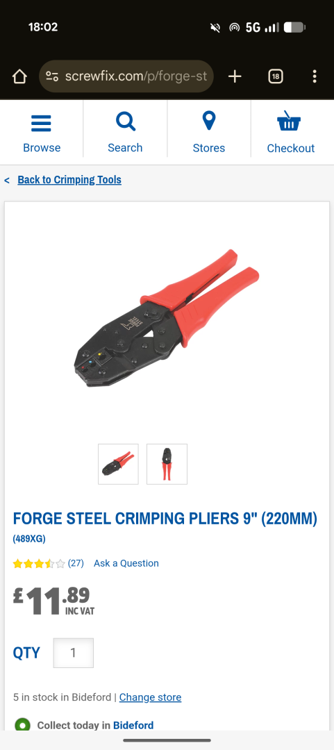

I bought these years ago. Used lots for van conversion and bits and bobs, seem to do what I want. Screenshot_20260207-180237.png

Update:
Bought a small corded heat gun from Amazon and it does an admirable job on the solder connectors I have.
