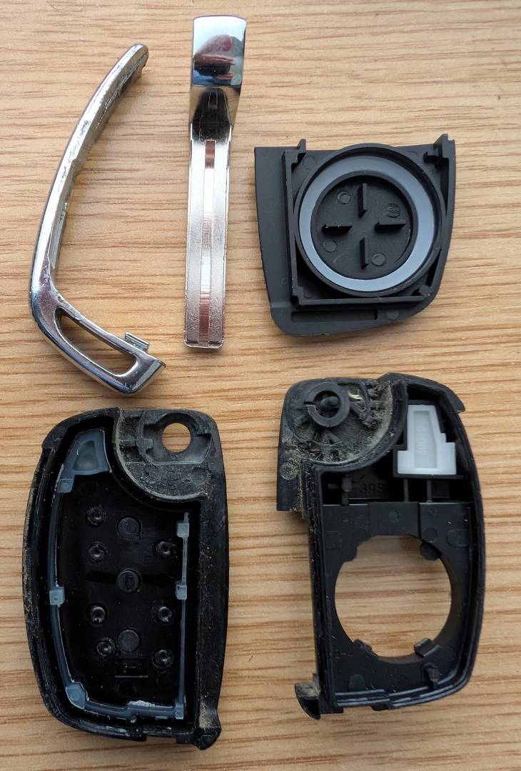

I transferred the small circuit board over, is that different to the transponder chip?ย  The new FOB unlocks/locks the doors electronically but won't start the car.ย  I have attached a photograph of what is left of the old FOB.

That white piece will contain a transponder. Swap that over

Yup, what fossy says.ย  You can just hold it next to your ign switch to check while you turn the new key, it should recognise the old chip if it's near and disarm the immobiliser.ย  If it's anything like the one on my MX5, it's hard work to get out of the old key.

You were correct Fossy but it was a tiny black chip underneath that piece of plastic!ย  It blended in so well with the casing that it wasn't obvious, at least to my old eyes! Thanks again
