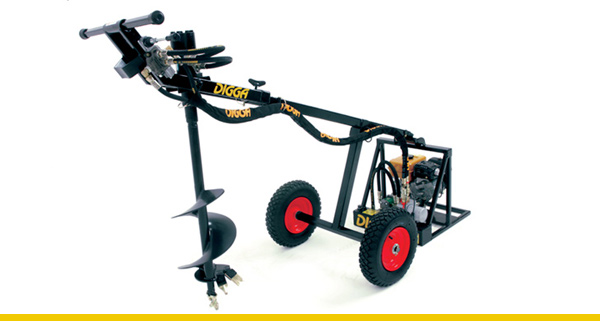

Post hole borers like your pic are good up to a point buy they can fling you about a bit, even with a clutch, when they hit obstructions. I had to site a sculpture that needed 10 holes - only on arrival was I told that the site, a park, was on the site of row of demolished houses, which had then been a roads materials depot- every hole a unique battle. I started at 9am and didn't get off site til nearly midnight!
Watch your wrists
and the ligaments in your knees when it breaks free, spins and smacks them sideways
There are bigger freestanding borers that can be operated by one person and are much better behaved - will seem like overkill but thats because they'll do the job really quickly and easily, and without pain or rude words
Hired theres not usually that much difference price wise between them and the smaller two man ones
Posted : 05/05/2012 5:04 pm

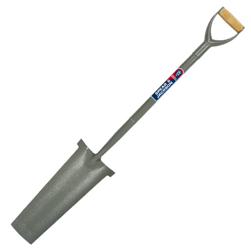

Have used a Stihl post borer for most of these:
The leading edge of the auger has a sacrificial blade. These wear out and cost quite a bit to replace. Hire ones dont tend to replace them as often as they should - blunt leading blades make for VERY hard work. Stony ground is a git, clays and loams are quite satisfying.
Never hit a root so cant comment.
Personally for 8 Id be mor ethan happy to use one of these (the narrow blade is quite tightly curved) and the hole scoops neil posted. Very therapeutic.
Posted : 05/05/2012 10:00 pm

Check for services before you start digging.
The types of spade pictured above are good, however you can knacker your hand/wrist if forcing it into the ground and you hit gravels it will just stop.
You want that design, but with a longer shaft with no handle on the end, this way if it hits anything it just slides through your hands. Also as the handle is longer when you get deeper you don't need to dig on your knees.
http://www.wickes.co.uk/long-handled-fencing-spade/invt/199088/
Posted : 06/05/2012 8:30 am
