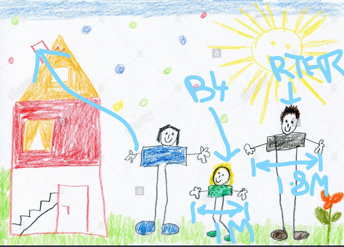

I love the idea of drawing it up myself, but I think a montage of "Stickman pointing at Chimney", "Stickman holding arms 1M apart", "Stickman holding arms "1.8M apart" might not do the trick. Any surveyors on the forum willing to give it a go?

I love the idea of drawing it up myself, but I think a montage of “Stickman pointing at Chimney”, “Stickman holding arms 1M apart”, “Stickman holding arms “1.8M apart” might not do the trick. Any surveyors on the forum willing to give it a go?
You're welcome.

Job jobbed.
