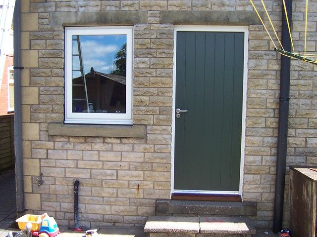

I got a composite for my outbuilding but I had it modified to open outwards, had green outside and white inside so it cost about £420.
Mate fitted it for mates rates.
Posted : 25/01/2016 10:30 pm
