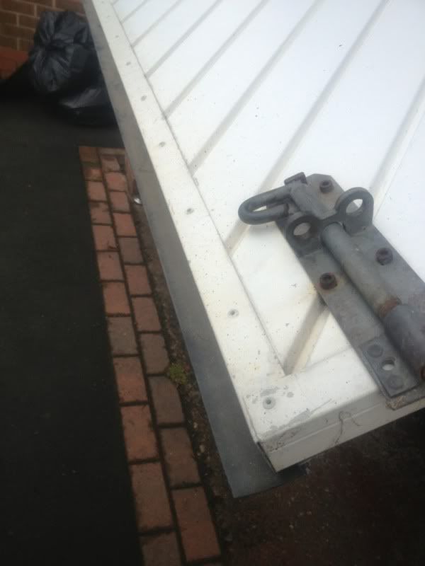

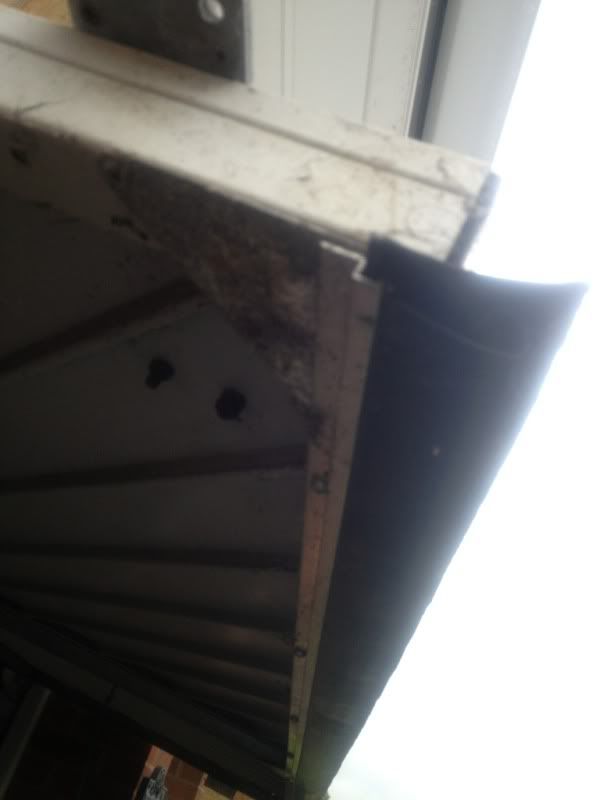

I do a lot of fishing as well as cycling so the garage always smells of bait and is like a proverbial foodhall to mice, best way I found was to put a rubber strip along the bottom of the up and over door , I riveted it on and made it slightly too long so it folds slightly one it hits the floor and gives it more strength and no gaps.
Worked for me as had the little bleeders getting in the house by going up the box work for the stenchpipe(integral garage )and into the bathroom above and then running all over the house via the space between ceiling and floor upstairs.
Will get a pic up in a bit but just make sure the rubber isn't too thick, I can't remember what I used but t wasn't proper proofing just something I had to hand

Here you go eskay, i actually think it is the proper stuff looking at it or a draught excluder thing, it was10 years ago so I cant remember lol

Thanks for the pics and comments.
