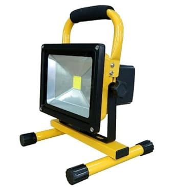

A couple of portable work lights? They will give up to about 3 hours. Can be found at places like B&Q for around £20.
Screwfix do a version that charges from the lighter socket in your car (they also have a USB power out so you can use them as a power pack for phone charging etc too. )
Very bright (if you choose wisely) but a lot of thought needed to how you place them where you're working otherwise you're constantly either dazzled by them or casting your shadow on the thing you're trying to work on.
I keep a few in the van for site jobs and usually wedge a sheet of polystyrene up against the ceiling and bounce the light of that to get better diffusion.
Excellent alternative to halogen site lights though -, great not having cables to trip over and they don't blow the fuses and set fire to everything 🙂
